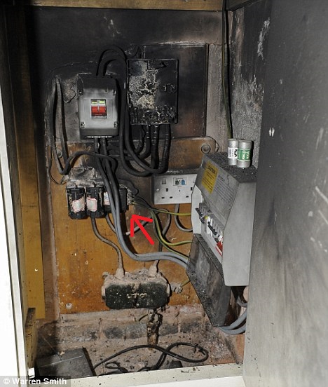

where the seat of this fire is the MET or the cable between MET and the Neutral in the cut out. The neter is not damaged but is covered in soot. Not a power surge but copper theft. Loss of Neutral would have meant some properties would have had higher than 230 volts due to phase unbalance in the area.

I have seen where road works broke the neutral with TN-C-S, the problem in that case is anything which has a true earth will carry the neutral current, the damage was burnt earth wires, and in extremes it can rupture the gas pipe which then has a follow on result. However looking at the picture.
met-fire-jpg.119313
major burning seems to be the meter, so it looks far more like a faulty thread in the meter connections has resulted in the torque wrench showing correct torque, but the cables were not tight. The problem is once heated up likely the faulty thread has likely cured its self, and it looks as if the meter fitter did not tighten the screws fully.
I am sure thieves stock did steel the copper, what is in question was that the result, or was it a handy stock image?

So come on lads, does that really look like lost neutral damage, or a faulty meter damage?

Further down the article is a close up of a meter, it was assumed this was the meter from the burnt out meter box.
no damage at the terminals and some of the soot has been brushed off. Even if it is not the same meter the lowest point of fire damage in the MET and the conductor from the MET that runs across the top of the cut out and goes up out of the top left hand corner of the box.
and the other 70 homes that had been damaged by the "power surge", did they all have faulty meters ( before the event )

That meter looks different to the one in the first picture.
