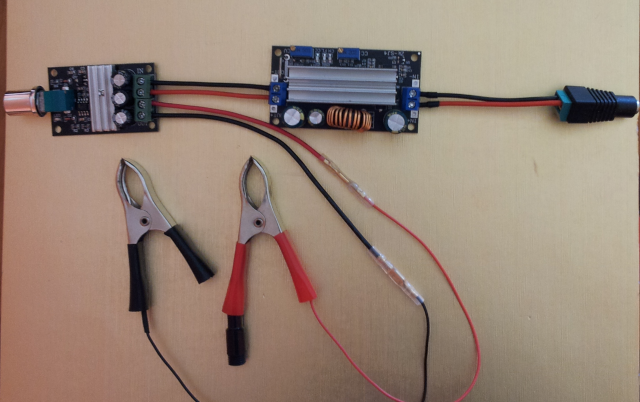

Here's the final prototype for my charger controller. It uses a standard china 5A 4.5V-30V DC motor PWM controller that generates pulses of the input voltage and current at 20khz with variable duty cycle. For purpose of battery trickle charging, the minimum duty cycle can be used. The output to the alligator clamps are gated by a couple of 1n5391 diodes. Voltage feedback from the battery to the controller stops the controller from working properly. The diodes block this feedback. What remains missing is a couple of fuses to protect the controller from the battery, or vice versa. A fuse holder has already been attached to the red clamp. The red lead will be connected to the other end of the fuse holder.
I believe high voltages charging is beneficial. But high voltage at 14.4V or above causes loss of water. The compromise I have chosen is to pulse high voltage in very brief periods. This should reduce or eliminate water loss. I am willing to bet my batteries on this theory that I pulled out from thin air.

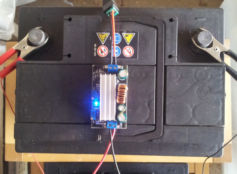

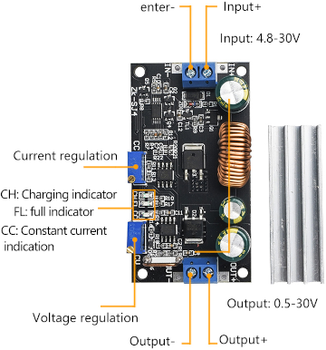

Although the PWM controllers work, these are not ideal because I didn't know better. Next I am getting a proper controller. This will give me a mini lab-PSU and finer control over the charging power. This 3A unit can step up as well as step down the input power, giving me the ability to use all kinds of ACDC adaptors.
Further experimentation with high voltage (24v) and low average amperage (<5mA) using PWM controllers produced no gains. Nor, did it make things worst. This configuration would have charged batteries but not able to rejuvenate worn batteries.
Then the mini lab PSU arrived. It offered significantly better control over the output. But it had some limitations: for instance I could step up the 24v 1A adaptor to give me 26v 10mA. In order to get 30v, the output amps had to be 20mA.
At 30v 20mA, nothing exciting was happing to the battery being charged. At 30v 40mA, things started to move, with both the battery voltage and CCA being lifted. To replicate the solar panel that was capable of charging a battery to 16v, I may have to increase the feed amps to battery to 80mA. At 30v 40mA, there was light bubbling in the electrolyte, which I consider subjectively to be acceptable, especially when resting intervals are used during charging. 30v produced uncomfortable arc'ing that was eating away my multimeter probes and crocodile clips. The solution was to turn off the charger when connecting or disconnecting it to the battery.
Currently, using 30v 40mA, I got the 075 battery to the max 406 CCA level previously attained. It seems hopeful this could be exceeded. If not, I still have the head room of another 40mA at my disposal. A lot more mA's are available, but the electrolyte bubbling would become unacceptable.
