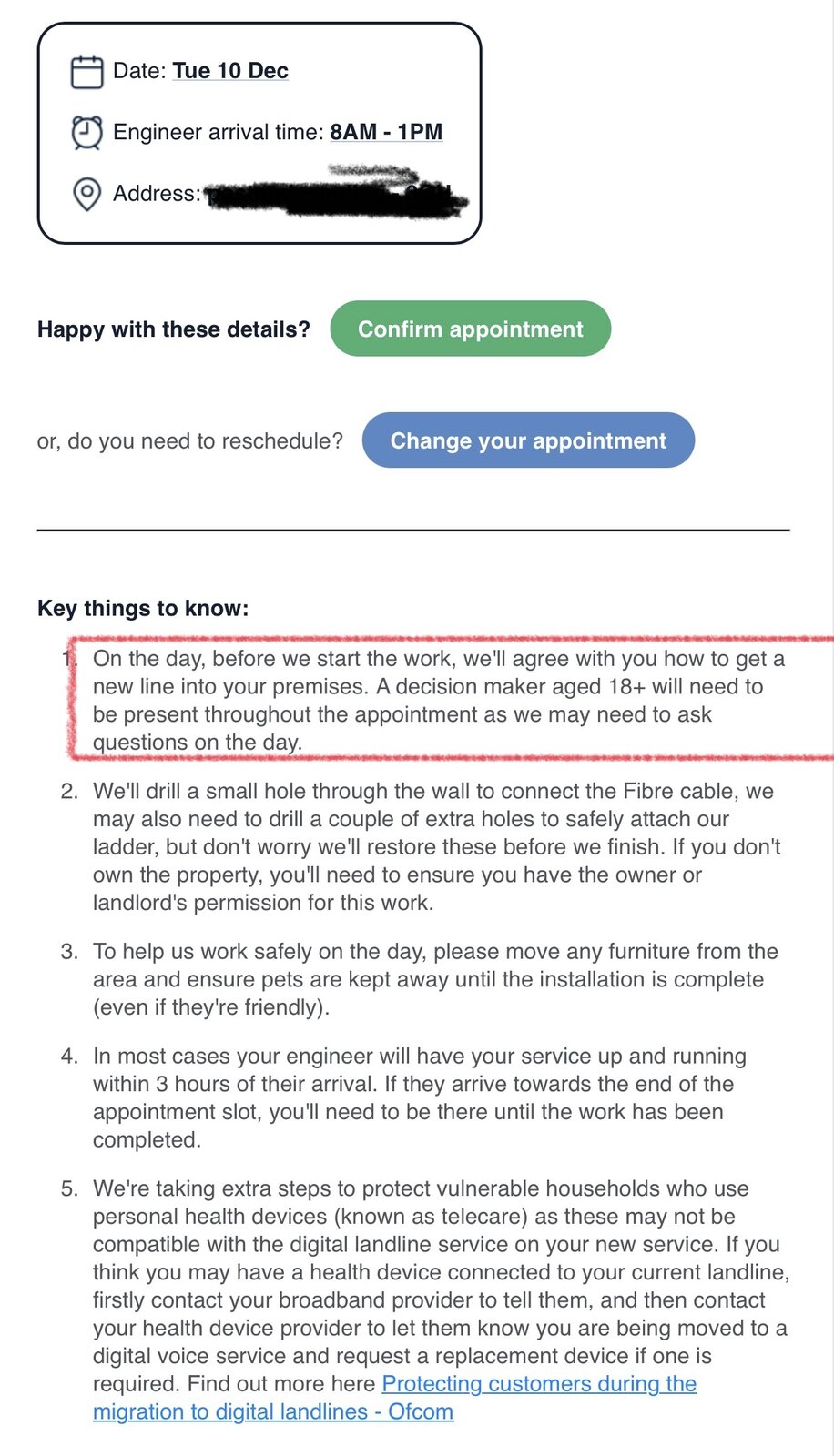

On the same subject, I’m having my fibre installed on Dec 10th but we have no telephone poles in our street. We did have cable about 20 years ago (NTL) and I seem to remember they used a moling machine to get to the house from the street, going under our lawn. We no longer have a lawn, it’s been replaced with a drive with a pretty substantial reinforced concrete slab that I fitted myself (the slab, not the surface pavers). I’ve just had a look outside. We have one 'normal' phone line connection box and one cable connection box. Whether they can use the existing cable remains to be seen.

I’ve already had instructions from Mrs Mottie that it’s got to be a neat installation on the day or they can go away!
just watch out they do not charge you for a "missed" appointment when you do that
Not only do you need to know (and plan) how the external fibre 'cable' will come onto your property. Who is doing your provision? If your supplier is using OR to supply the fibre to the house it is possible they will find a means of using an existing duct.
Do make sure you know where inside you want the ONT locating - normally close to the router position but moving to FTTP could be the chance to improve the location of such in-house kit. (If you are reliant on WiFi centre of the house at first floor level seems to be best and cuts down the need for extended units (BT speak - Halo).) You will get a grey box external fitted to the house about 12-18 inches off the ground where the external to internal fibres are joined.
The ONT will need its own electric point along with the router. The router and ONT do not have to be close together.
It is Open Reach. But not to worry, they say they are going to discuss it first. Too bloody right they are!
