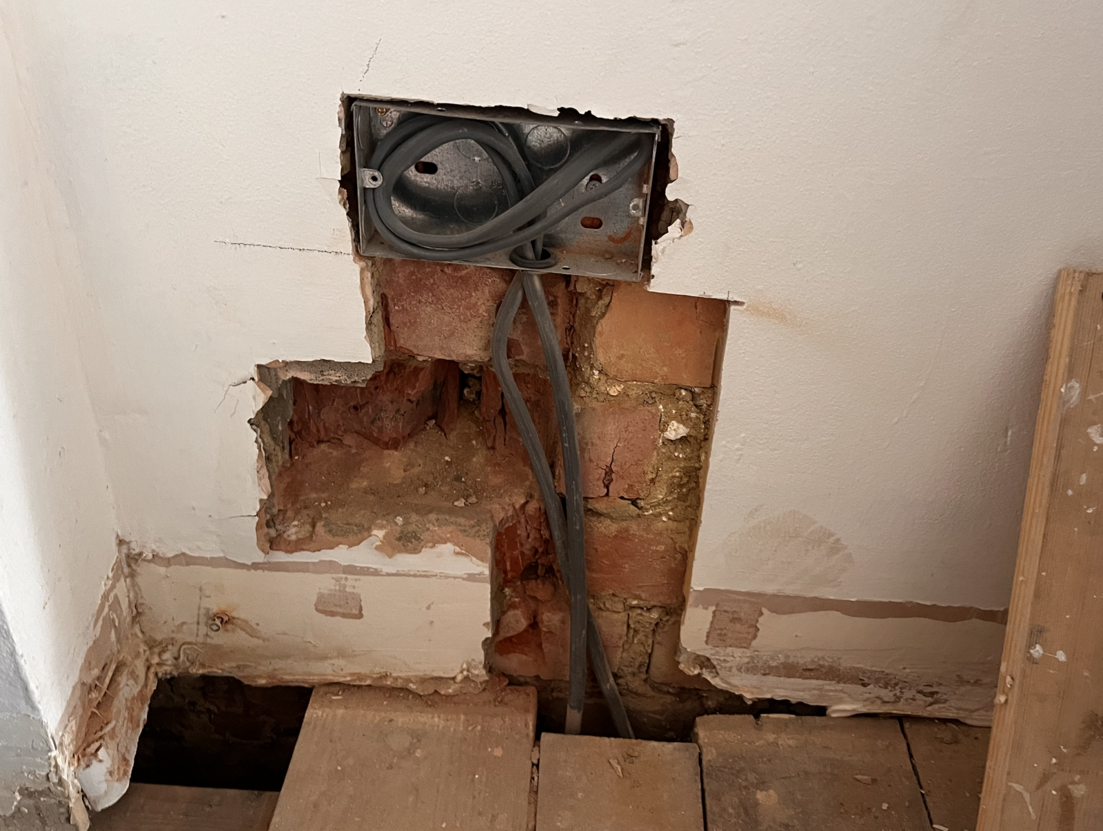

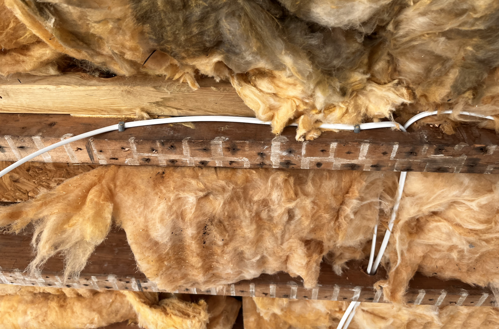

The interest of NICIEC (and the other 'scheme providers') seems largely restricted to collecting subscriptions from their members!
its terrible, even more so when some members make it look like their membership with the NICEIC is there to protect you 'the customer'

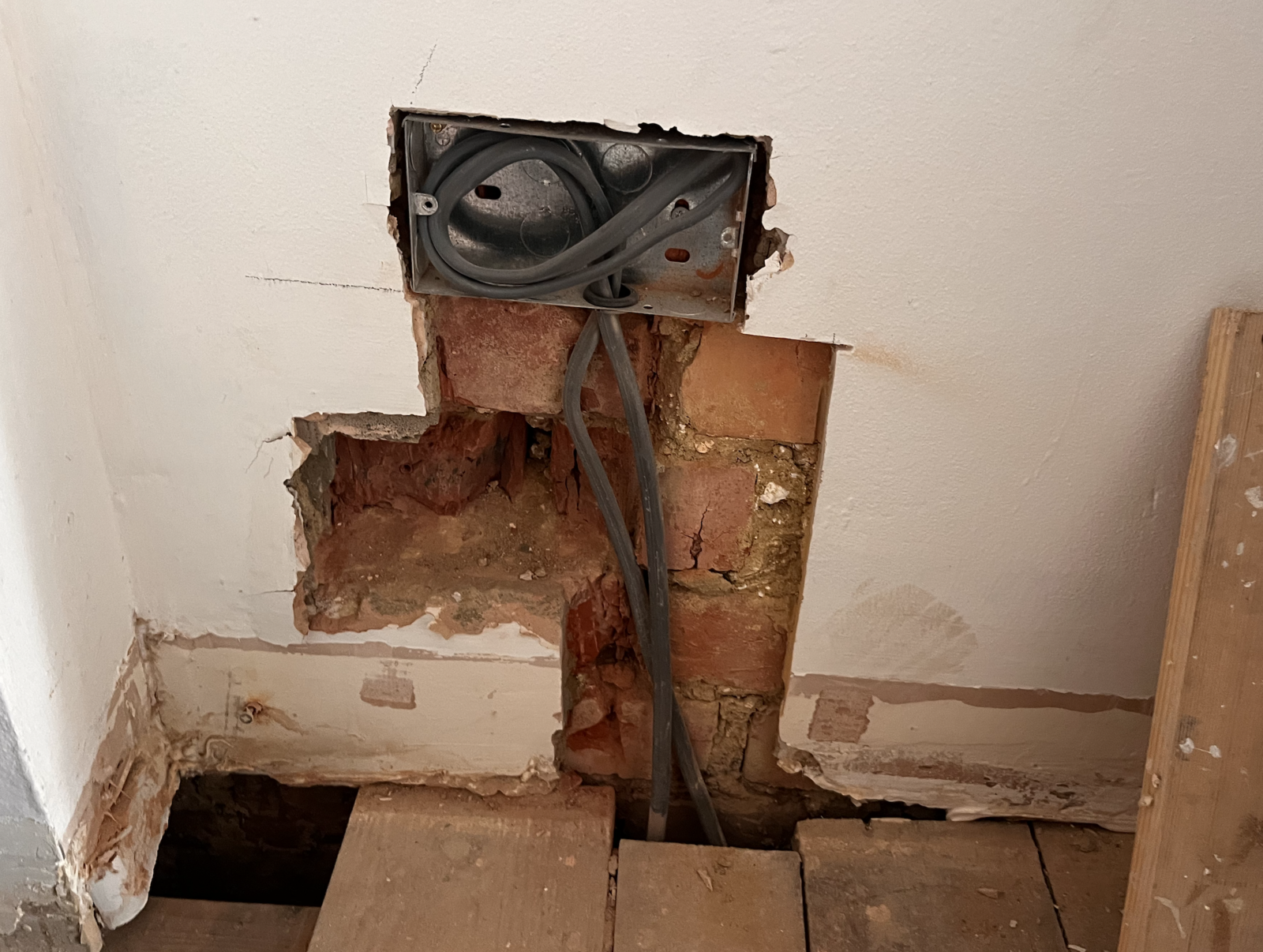

Do they not own a spirit level?
Appalling and if that lighter cable is for lights why is it next to a socket?
Alarm bells ringing
Thats some of the worst first fixing I've ever seen, I hope you haven't paid.

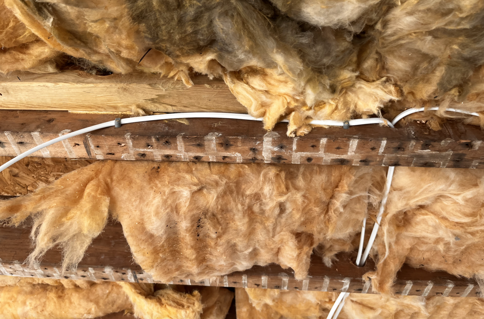

Joists drilled in wrong place.
Not putting in oval conduit or capping, though not actually a requirement, is usually the sign of an electrician who doesn't care.

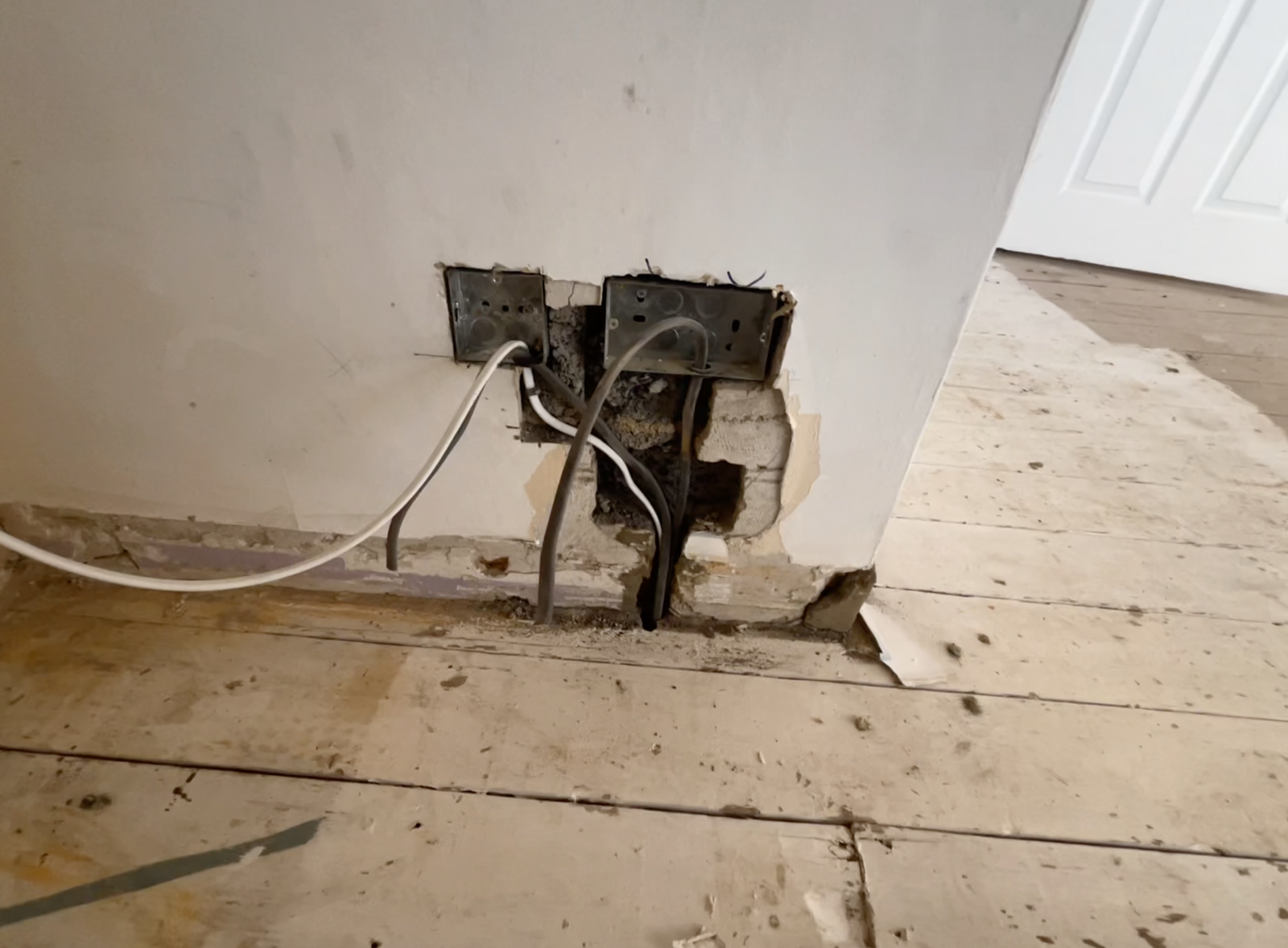

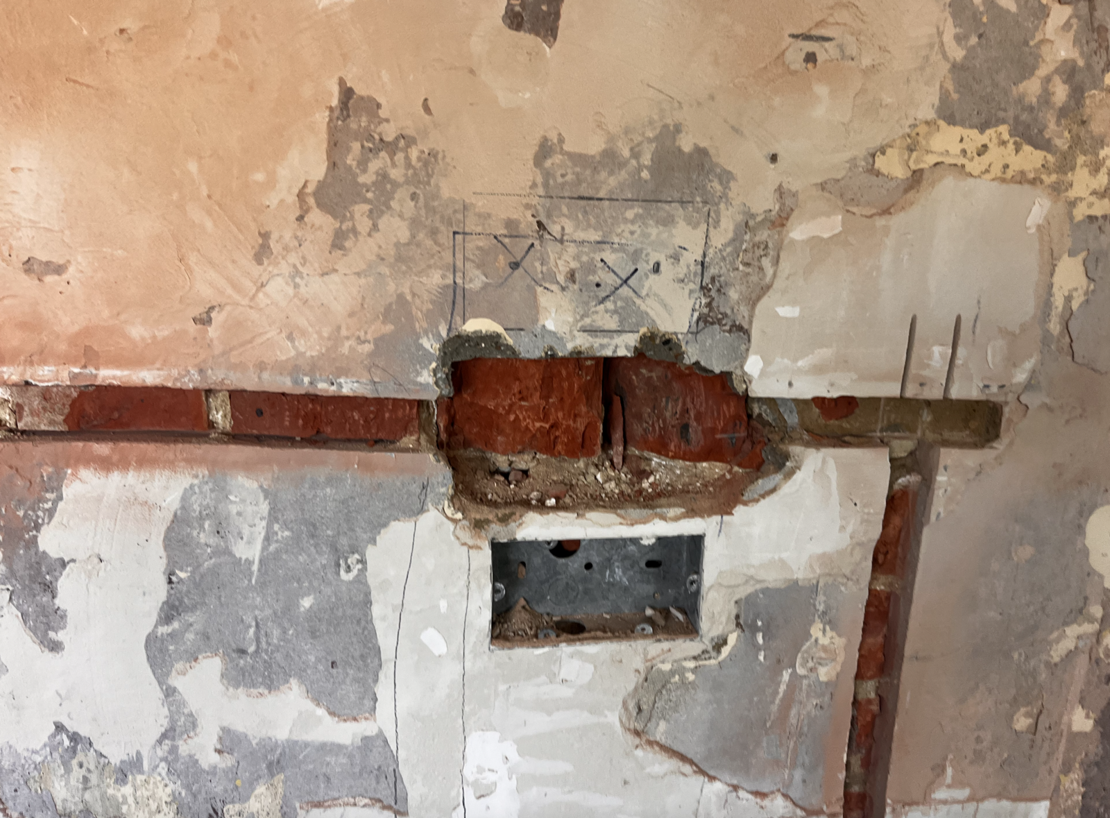

The biggest concern for me is your very first picture, where the cable isn't even close to being in a cable zone.
Appalling and if that lighter cake is for lights why is it next to a socket?
Alarm bells ringing
its meant to be for an isolator switch for a ventilation fan in the room
haven't paid yet but problem is I don't know how to challenge this as NICEIC wont do anything unless I have a written complaint and give the gy time to fix but we don't have time as other trades need to get in
I read somewhere that the clips need to be metal too, does this apply in this case ?
Not if they are going to be buried in plaster.
In essence, the only situation in which clips have to be metal is if they are the only thing stopping cables falling and getting in the way of fire-fighters if they melt (which they might if plastic).
Maybe my comment was a bit harsh, it's the first couple of pictures that are not in zones, get him to tidy it up a bit.
Flipping heck, even I as a non electrician would do a far better job than that.
I would be telling them to keep off site, not paying and obtaining another electrician (one that will actually prove he is qualified) to redo it correctly.
I see, so I assume the same would apply in ceiling joists as they are covered with plasterboard isolating them.
he could argue that he would want the money for the first fix, I'm not sure how to argue my way out of this. I was thinking of getting another electrician to inspect the first fix then report back.
