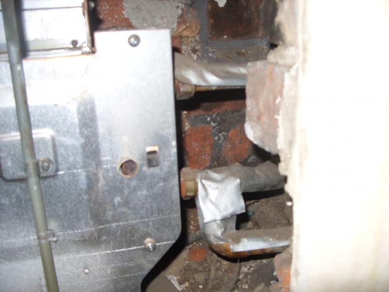

it is hard to make out from the photo, is the 3port B connection going to the bottom or top cylinder connection?
Matt
Port B goes to the top pipe in cyl.

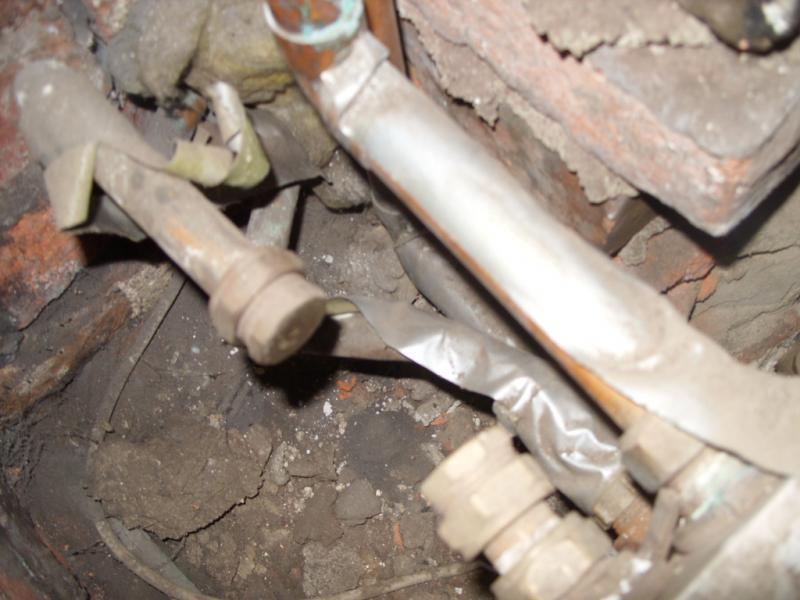

The return pipe we thought was getting hot was the 15mm which teed off to 22mm towards the boiler, this is capped off. i can only make a reasonable guess as to which of the 28mm pipes is which when it goes through 8 inch of chimney, even so, from this point up to the pump/cyl i cant tell which is which, hence my suggested test or any other, the heat test with pump disconnected definatly showed both pipes getting hot in different tests. My suggestion of disconecting the port B and top of the boiler to find out if these are both the same pipe could resolve this baring any hidden tees which we cant varify anyway.
The pipe at top is 28mm flow.
The pipe at the back top is the 22mm flow that is capped when it changed to fully pumped.
The bottom one is the injector tee with 28mm return at bottom of tee and 22mm heating return at side of tee.
There could be trace of where the old heating pump used to be with a piece of pipe in place of pump. Could be in box in or under ground floor.
This is fine. Correctly piped.
The best way is to trace / look both 28mm pipes from boiler tappings to cylinder tapping/pump inlet. Take your time and work out. Any good pipe fitter like me can work out which it which.
