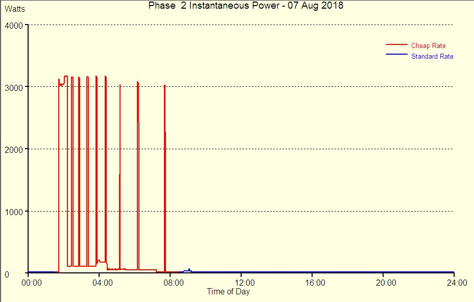

Normally gas, but the immersion is there for backup. For the purposes of the test, I ran it on electric only, allowing it several days to settle and then several days for measurement - just reading the meter several days apart and doing "energy used / time" to get an average for standing losses.

If, due to a period of low demand, cheap electricity became available during that period and my immersion were remotely switched on, I would actually use very little of that cheap electricity, because my 'thermal store' was already almost 'fully charged'.
Apples to oranges comparison. You have E7 and (AFAIUI) the Mixergy (sp?) system does not need that. Also you are always (normally?) fully heating you water tank every night whereas the Mixergy 'smart' system looks at the usage and only heats enough water for what you will need and so there will be capacity to use cheaper electricity.
Not that I am advocating that system. Just that it is a different approach and any comparison must be a valid one.
