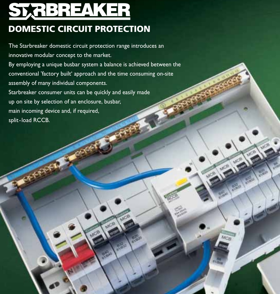

The consumer unit is much older than 12 years. Starbreaker units 17 years ago in 2006 looked like this:

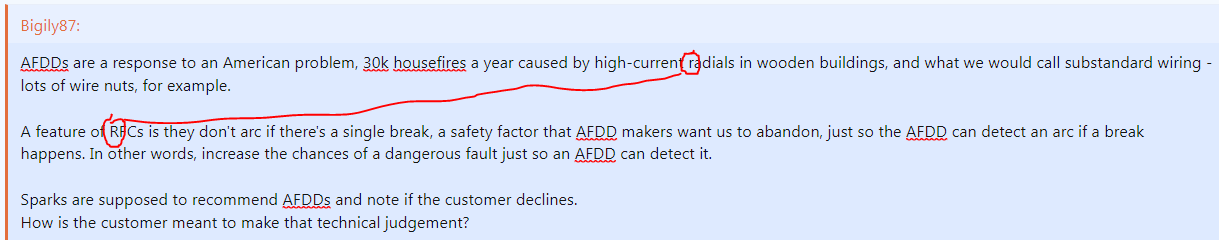

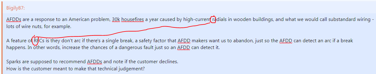

AFDDs are a response to an American problem, 30k housefires a year caused by high-current radials in wooden buildings, and what we would call substandard wiring - lots of wire nuts, for example.
A feature of RFCs is they don't arc if there's a single break, a safety factor that AFDD makers want us to abandon, just so the AFDD can detect an arc if a break happens. In other words, increase the chances of a dangerous fault just so an AFDD can detect it.
Sparks are supposed to recommend AFDDs and note if the customer declines.
How is the customer meant to make that technical judgement?
