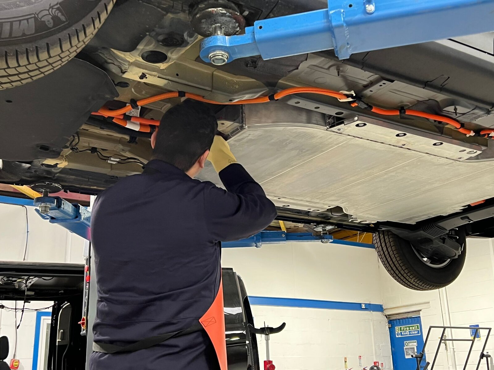

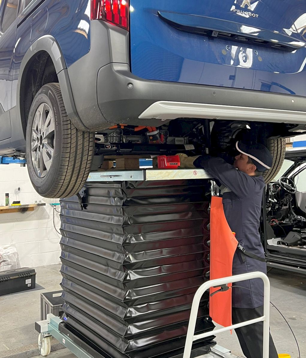

It's easy in some ways, harder in others. Theoretically, it's very easy, because the battery pack is bolted to the underside of the car. You just unplug the cables, take the bolts out, and it's on the floor! In practical terms, however, it's bloody heavy! A big battery pack can be up to half a ton. We do this at work. (Obviously, don't tell NutJob, but the factory burns down twice a week. which is getting a bit wearing now... ;) ). We lift the car on a conventional 2-post hoist, and then we have a little scissor lift on a trolley that goes under the battery.

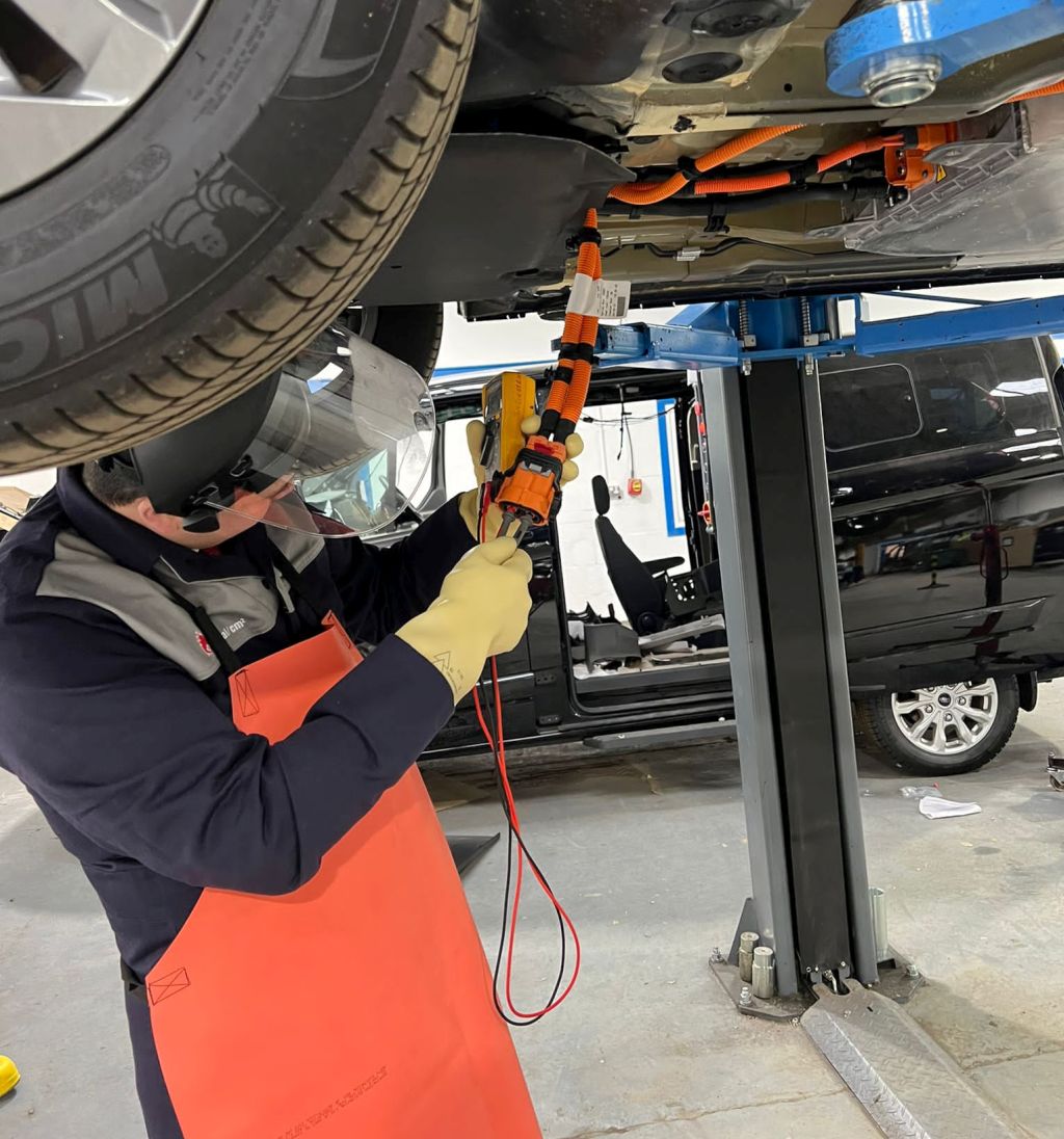

There are IMI courses that the technicians have to go on - Levels 1-4 I think, and various PPE (the big rubber "clown shoes", apron, gloves, etc). The car will have a battery removal procedure, but it's basically a case of making sure everything is isolated and then just disconnecting the hoofing great connector.
And making sure it's not live:
once the battery pack is unbolted, you just lower the scissor lift and wheel it out from under the car. On some cars, there would be heating / cooling lines to disconnect as well.
