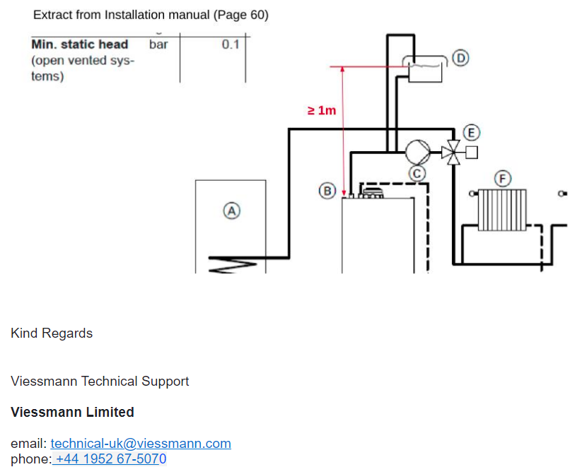

Given Viessmann have sent you information stating that 1m head is within spec,
Have they? The only one I've seen is in #31, where the 40" was added by desktop.
In any case, 2.1 - 0.45 - 1 - 0.6 = 50mm bottom of boiler above floor. Flow and return out the top might be OK, but gas and condensate could be a struggle.
OK, missed that. I wonder if the Viessmann guy who sent it had read the manual in #50.
That's the manual for the variant that the OP has, which is not the US version of the boiler.
@desktop987456 , was it Viessmann US support that mailed you that min height info? As suggested as long as you have the height to provide enough head of water to fill and purge the system then fine, the height of the vent above the level in the cistern (450mm) is to allow for pump surge and expansion, so as long as you obtain that then I would hope you'd be ok.
I sent an email to Viessmann Technical Support UK, extract attached as received. The 1m mark in red color is from Viessmann UK, I have not edited it.
I am using the UK version of the manul.

OK - strange that they contradict their own manual - not to worry though, if they subsequently suggest that 1m head is the required distance and supply a diagram to show that then fair enough and that should ok.
I'll go ahead with installation with these dimensions and see if this works out.
