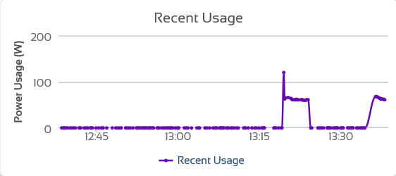

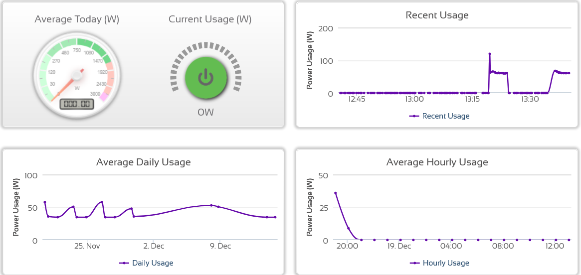

OK energy monitor on the chest freezer
120 watt start and 60 watt run. The chest freezer was a lot cheaper to the upright, and about the same size, I have put both on an energy monitor before, and average the upright uses more power even without opening the door.
How you can measure energy lost by opening a door I don't know? The more the door is opened on an upright freezer, the more often the defrost cycle is initiated so not only measuring heat gained, but also cost of defrost cycles. The defrost cycle is not a simple timer, when I had the energy monitor on the upright, sometimes 36 hours between defrost cycles, other times only 6 hours, so something measures something, be it how long door open, or how much frost, not a clue.
Note the second start it does not show hardly any in-rush, I have four screens 1734615682561.png and last time I tested I had each freezer run for a month to get a better average, the monitor was on a paper cutting machine before, so only the one screen tells us anything.

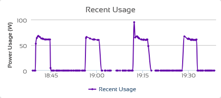

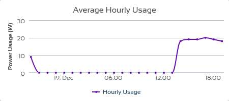

I also had a freezer, which I was testing with the energy monitor, if a freezer has lost gas, then it may never turn off, so I want to see the motor cycling, 1734637133073.pngI can see it cycling and that average is 20 watt 1734637194491.png so I am reasonably sure freezer is OK, but one freezer was not cycling, it was on all the time, so either the thermostat was faulty, or the whole freezer was faulty, but which? I tried to borrow or buy a thermometer, I could not believe how hard it was to find a high street shop that sold them, I failed, however the freezer temperature should be -18ºC and the freezing point of brine is also -18ºC, so I mixed up some salt with water, stuck it in freezer, and it froze solid, so ordered new thermostat, and at same time ordered a thermostat to control another fridge for brewing, the freezer had got down to -24ºC, but the new thermostat was the other way around, and only getting it to -16ºC when at lowest setting.
Now I use a redundant beer thermostat and set to +4ºC as don't really need 4 freezers. And use it as a fridge. That was another point, the very small freezer was using nearly as much as the big one.
