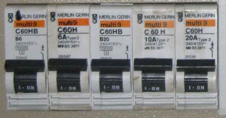

This from another thread:
It is actually a distribution board but if found in a CU would this have been type tested or is it not allowed?
Some Type 2, some Type B.
This from another thread: ... It is actually a distribution board but if found in a CU would this have been type tested or is it not allowed? Some Type 2, some Type B.
Why do you say that it's necessarily 'only a DB', rather than a CU? If it had been type-tested etc., it would surely qualify (per BS7671 definition) as a CU?
The answer to your question is obviously that (assuming the supply is ≤100A and under the control of "ordinary persons"), as far as BS7671 is concerned it would only be allowed if the arrangement had been type-tested. However, only the manufacturer could tell you whether a mix of Type 2 and Type B devices had been type tested. To some extent that will be dependent on chronology. If the board was initially (tested and) sold before the appearance of Type B MCBs, the initial type-testing obviously could not have included Type Bs, but they may have undertaken additional type-testing subsequently. If the board first appeared after Type Bs became available, I suppose they may well have included 'older type' (Type 2) devices in their 'type-testing'.
I didn't say 'only' but because it was/is a DB and to prevent the comment that that is not a CU.

I think the main problem with this discussion is that stillp is taking a 'very strictly correct' position, but that common sense is probably not being given as much attention as it could be. There is no doubt that there is a theoretical possibility that the proximity of an 'untested' could (I imagine very slightly) influence the behaviour of a 'tested' device, but, as I have said, I find it very hard to believe that the devices would be so 'marginal' in their design that this would be of any consequence in a domestic CU. Let's face it, for example, a B6 of the correct make is required to work satisfactorily in any orientation, even if sitting next to a fully-loaded B45 or B50, and over a wide range of ambient (and operating) temperatures and altitudes. If (as one would expect) it can cope with all of that, I find it very hard to believe that the proximity of a 'wrong make' device, or the fact that it was in the 'wrong enclosure', would, in practice, have any appreciable effect on the device's performance (or well-being).
However, having said all of that, and despite what BAS seems to think/imply, I would never 'advise' anyone to used mixed-make devices, and nor would I install a 'wrong make' one in anyone else's CU (other than as a temporary measure). However, as far as I am personally concerned (i.e. in relation to my own installation), I am far more concerned with such issues as how well conductors have been terminated in the devices than whether or not the devices are 'the right make' (assuming they 'fit' {again, in common sense terms, rather than stillp's 'micrometer' view}).
