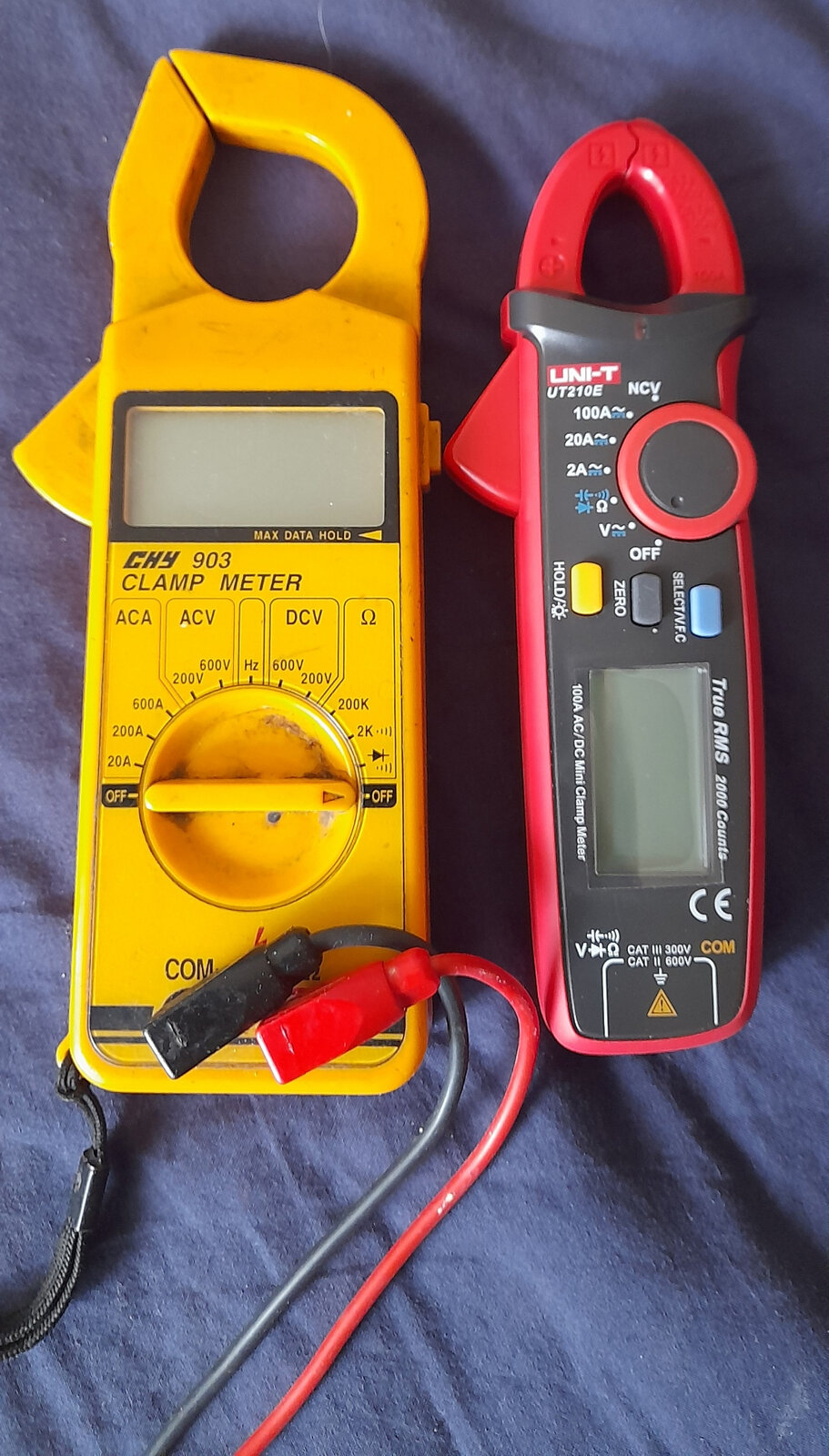

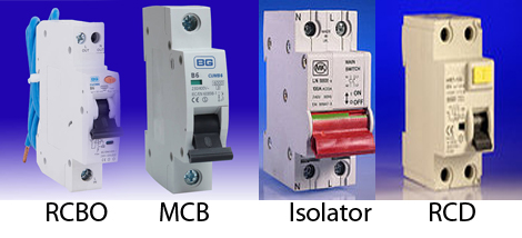

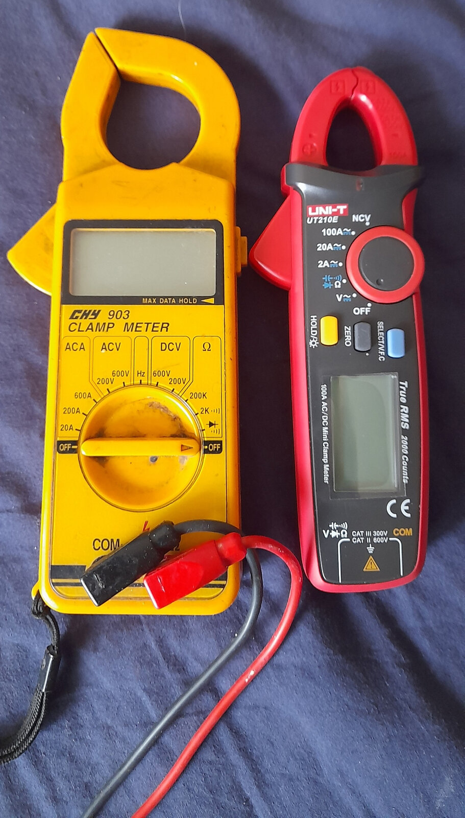

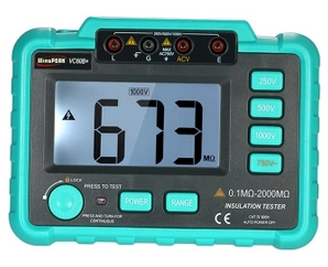

I tried to give same instructions, I do not want to try to give step by step instructions, only a guide as to how, as if he can understand the guide then likely safe doing the work, if not then likely has not got the skill to do it safely. However he will need some test equipment VC60B.jpgClamp-meters.jpg and without it the whole exercise is pointless, and depending on what equipment is available can change how tested. Since it is the MCB which trips

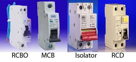

I have included a picture so he can confirm it is the MCB which will not have a test button, the fault should show on any continuity tester. Using the leads in the clamp on meters shown likely and use buzzer function to find such a large fault.
In the same way as I use pictures if @KPX33 showed pictures maybe we would have a better idea of how to test.
OP sounds to have a multimeter, which should respond to help locate a dead short.

I tried to give same instructions, I do not want to try to give step by step instructions, only a guide as to how, as if he can understand the guide then likely safe doing the work, if not then likely has not got the skill to do it safely. However he will need some test equipment View attachment 333516View attachment 333517 and without it the whole exercise is pointless, and depending on what equipment is available can change how tested. Since it is the MCB which trips View attachment 333519I have included a picture so he can confirm it is the MCB which will not have a test button, the fault should show on any continuity tester. Using the leads in the clamp on meters shown likely and use buzzer function to find such a large fault.
