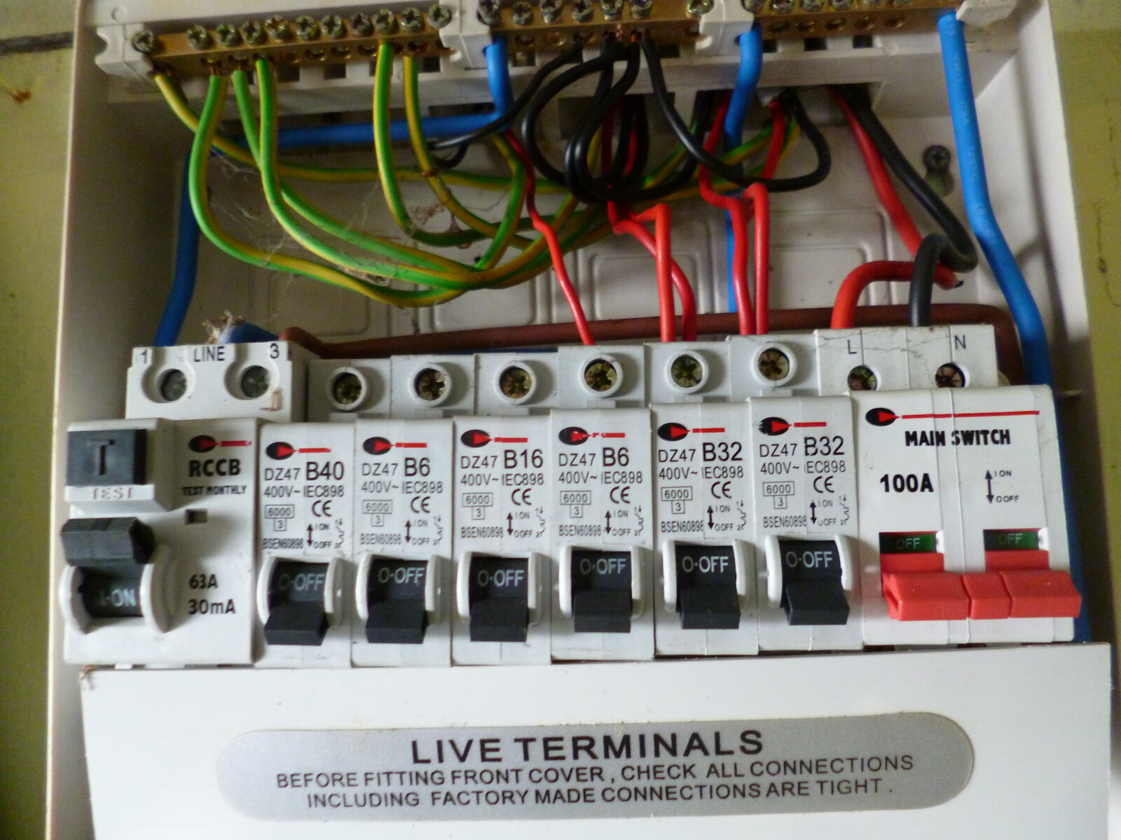

The 3-6 ohms are results from my circuit continuity tests that I took when progressively "halving" the circuit.
Do take the cover off and post a photo
Its a daft installation to say the very least
Cover off now.
If that installation is incorrect, what would be a correct installation ?
If it`s an incorrect installation, please advise the correct layout ?
The daft installation is to have this consumer unit attached to the socket circuit, especially as it appears to be on a spur from said socket circuit.
My advice to you is get a competent spark in
Sorry, question from the audience ...
Looking at that photo, is the supply coming into the isolator then feeding the three breakers, or is it feeding the RCCB which then feeds the breakers?
