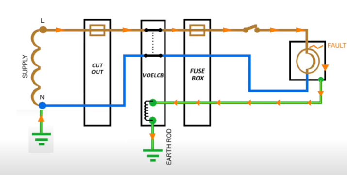

Nobody has mentioned that another very common problem with VOELCBs was that it could operate your neighbours trip if yours was faulty or non-existent. I had a callout every Sunday for ages when someone had their trip go at lunchtime. I visited all the local neighbours until I found an oven with dead short to earth and faulty trip. Reason: the affected house had, as been mentioned before, lead incoming water pipe, immersion heater and more importantly their earth rod within the resistance area of a neighbours. Result was the fault current found it better to go UP the neighbours rod and out via water pipe tripping their supply. I left them fighting who was going to pay.!!

Very good explanation, my only critique would be to suggest showing the Neutral to Ground connection at the substation to close the circuit loop
Indeed. Its quite worrying how some believe that the earth fault current 'disappears' into the general mass of 'earth' and don't appreciate that it MUST pop out again at some point & return to the 'source' ie. the supply transformer.
I've had some very long arguments with others trying to get them to understand that the fault current flows up the earth rod (ie. out of the ground) and to the transformer star point in a substation, or on a generator star point earth for that matter.
