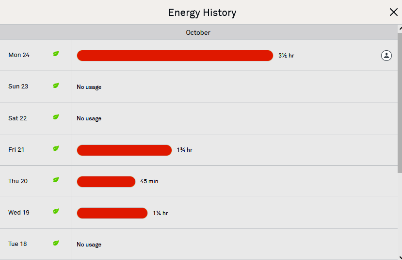

Interesting, we have had one or two cooler days where the heating has cut in, but here in a Mid Wales valley the heating has not been on much yet. 1666659123171.png A bit misleading as it shows how long the boiler has been switched on for, not how long it has run for, it tends to run for 20 minutes to get the circulating water hot, but then starts to cycle. My boiler does not modulate.
I have at last found my thermometer, just need so thermocouples now, but I have a 18 kW boiler, but unlikely at this time of year that many of the TRV's are open. I hear the TRV motors run from time to time, dinning room 15ºC hall at 16ºC at radiator but 18.5ºC at wall thermostat, living room 18ºC and 19ºC and this room my bedroom at 22ºC and the problem is down to these widely different temperatures, when cold outside the heating works well, but when mild the hall is not cold enough for the main thermostat to fire up the boiler.
So I end up manually turning up the wall thermostat as one room which I want to use is cold. Programmable TRV's do nothing if the boiler is not running.
Late mothers old house worked spot on with a modulating boiler 7 - 25 kW the programmable TRV's worked very well, once winter arrived the boiler kept each room at temperature set on the TRV within a degree, only the sun on the bay windows caused problems over heating living room, and only by a couple of degrees.
My last house was open plan, and the fan assisted Myson radiator worked well, but this house built into the hill side, cheap to heat, but control is some what lacking. However having new patio doors fitted, so not worth doing anything until I can monitor how this changes the way the house heats up.
