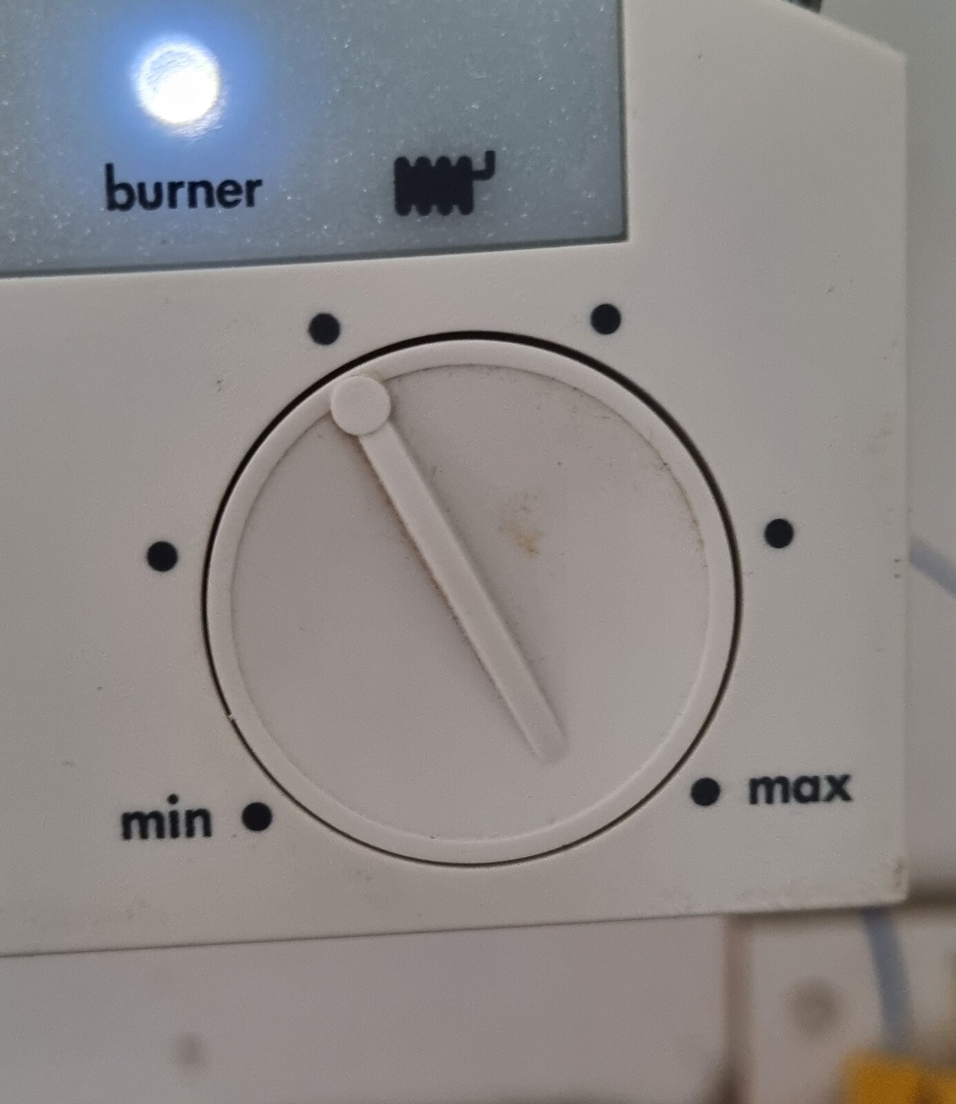

There are 6 pips on the temperature control knob, and the manual says it goes from 30 to 80C. So logically, each pip should be 10C and I've attached a picture of where I had it set which should be 50C.
So I fired up the hot water and watched the temperature control. It throttled back (modulated) at 69C when the return temperature was 59. Then the temperature gradually fell to 67C with the return temp at 60C at which point it shut off.
Surely this is not working correctly? The temps fell to the mid 40s which was the temperature in the tank, and the burner didn't come back on at all.

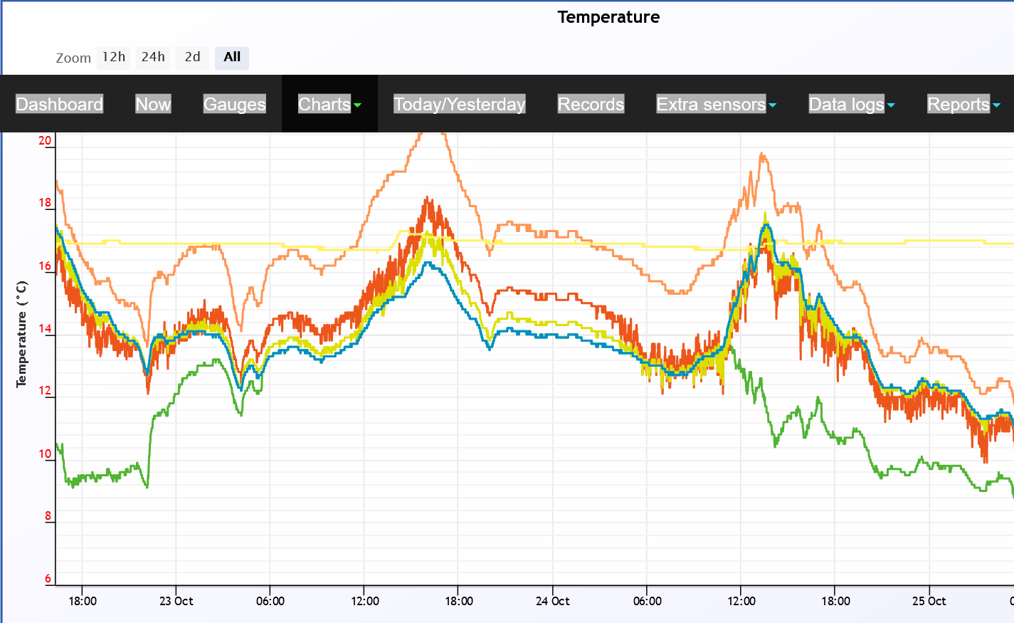

See the graph below. Yellow line is indoor temperature, in a cooler part of the house, actual is a degree or so higher. Blue is the outdoor temperature, Green the dew point.
Sharp step up at 13:30 23rd, is due to solar gain. There has been no CH on at all so far this autumn, just the living room gas fire sometimes on an evening, which is remote from the temperature sensor, so it doesn't see any warmth from the gas fire. It would see heat from the CH.

That does not seem correct, can you ensure all rads are calling for heat, may have to increase roomstats SP and open TRVs fully and repeat that test with no HW request.
Great data. What sort of set up is that?
