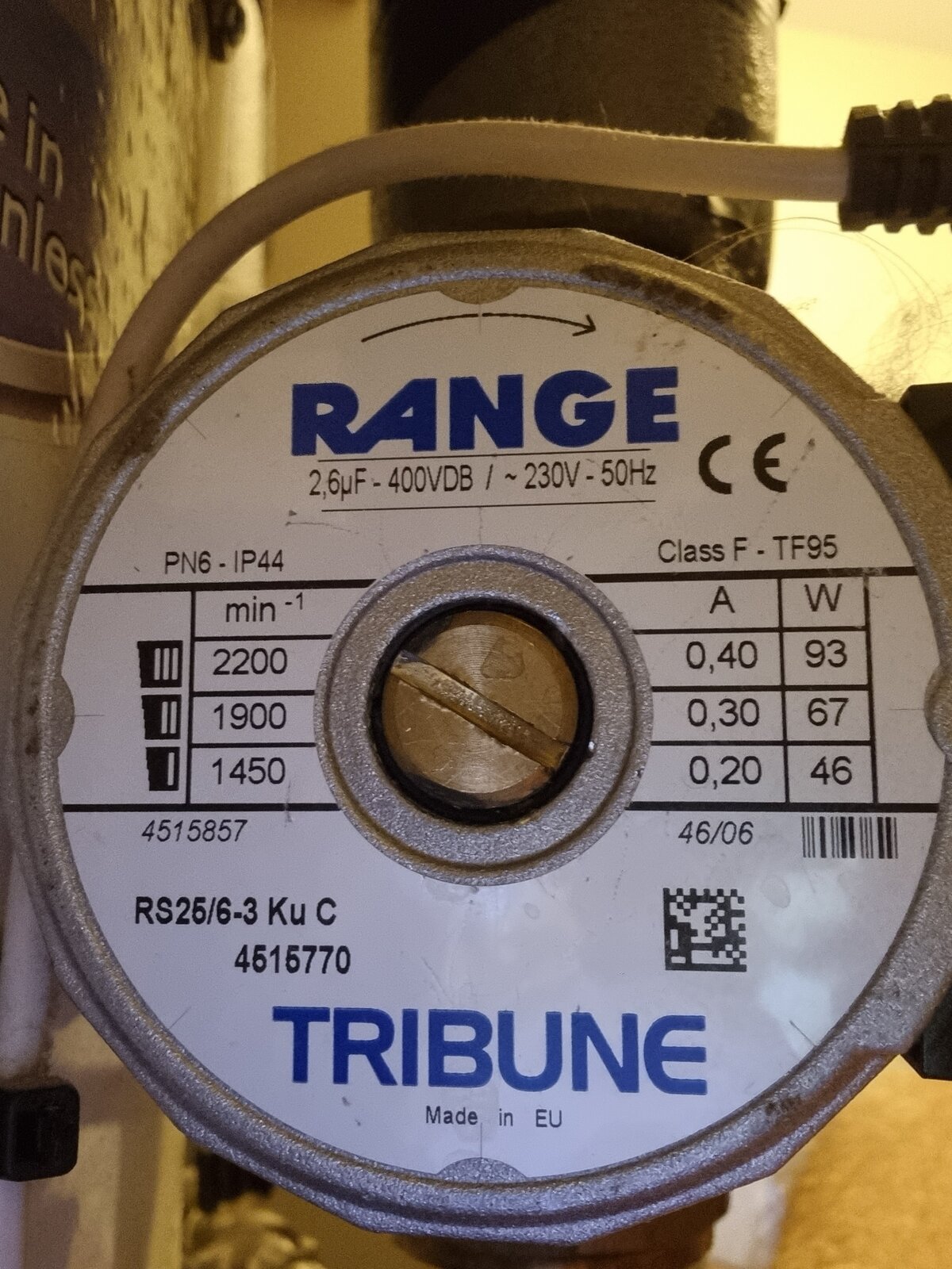

Is the circ pump installed internally in the boiler or externally?, if external, post make/model/setting.

The pump is a Range Tribune, I've got the flow set to low which is 1450 I guess litres per minute.

I think my pump has been installed the wrong way round.
Looking at the boiler manual the pipe on the right should be the outward flow and obviously hotter. But it's the colder of the two.
This would explain my symptoms as the boiler is trying to modulate the return flow!
And maybe also why the rads upstairs get hotter far quicker than those downstairs. And why there are always bubbles in the pump!
If the return is hotter than the flow, when the boiler is actually burning [1], then either the boiler, or the pump have been installed the wrong way.
[1] Be aware, that you can get a reverse flow, due to convection currents, when the boiler is not actually burning.
Looks like the pump. They've installed it with the writing the right way up but the flow arrow pointing down. It has two isolating valves either side and two big screw connectors. I can shut the valves, release the pressure via the bleed screw and turn it round, I don't even have to release the pressure in the system.

I flipped the pump around - easy enough except that I didn't have any replacement rubber washers. The old ones were quite knackered so I greased them up and refitted anyway, and they somehow haven't leaked! The temperature controls now work as expected - you can set the flow temp to the fourth mark on the dial which would be 60C, it goes up to 62C or so quickly, then throttles back and continues to run for a good long time to about 65C with a return temp of 53C or so, then it shuts off. This is exactly what I'd expect. Sadly there is no short cycling protection on this boiler so it can end up doing that. However I've adjusted the flow rates and the position of the wireless stat so it doesn't do it - the stat gets warm enough before the short cycling happens.
But then the problems started. I could hear some dripping sounds from within the boiler - odd. Then when looking for draughts under the cupboards I saw dripping white milky water. I put two and two together: With the flow running backwards the condensing heat exchanger was hot rather than cool so the boiler had never been condensing in the 15 years we've had it except for a minute or two on start-up. So these few drops of water and 14 years of accumulated crud (yes, we didn't get it serviced!) in the bottom of the combustion chamber had completely blocked the drain hole and s-trap with hardened black crud. Now that the boiler was condensing properly the inside had filled with water and made a nasty slurry from the boiler residue. Of course, I got that all over the kitchen, but I cleared up the trap. Then I tested the rest of the pipe by squirting water in, and none ran out - another blockage. Well eventually I checked under the sink and found a layer of food-based gunge covering the end of the boiler drain pipe - there had never been any fluid running through it.
A load of mess and pipe fittings later (I had to build a temporary drain into the sink so we could have heat whilst I fixed it) it is now working fine, and I get a delta T in the boiler of 20-25C instead of 15-20C, so it's apparently running 25-33% more efficiently! I have tried to increase the flow rate to bring dT down a bit in accordance with the spec but that means less heat is being dumped by the rads so I get higher return temps.
Pump is much quieter now in general (in fact inaudible unless I open the airing cupboard door) and the bubble traps are in the right place to catch the bubbles so it's clearly been designed to run this way round and the original fitter had just put the writing on the label the right way up without checking the flow arrow stamped on the back of the pump.
