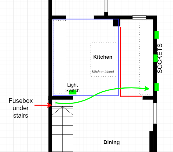

Thanks all for your suggestions.
Attached is a diagram of what I am looking to do. Blue box = timber suspended floor, Red box = kitchen extension with the concrete floor.

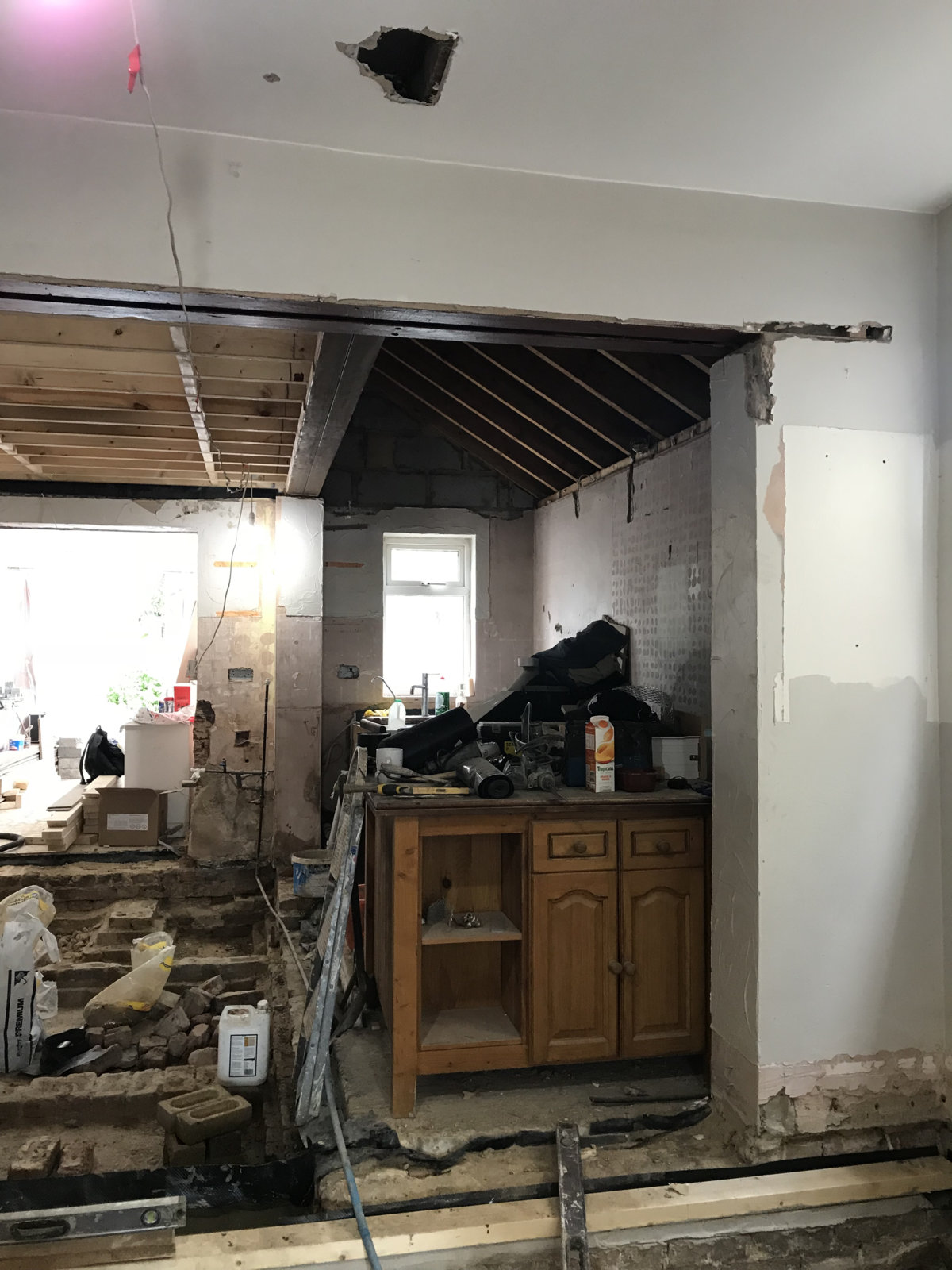

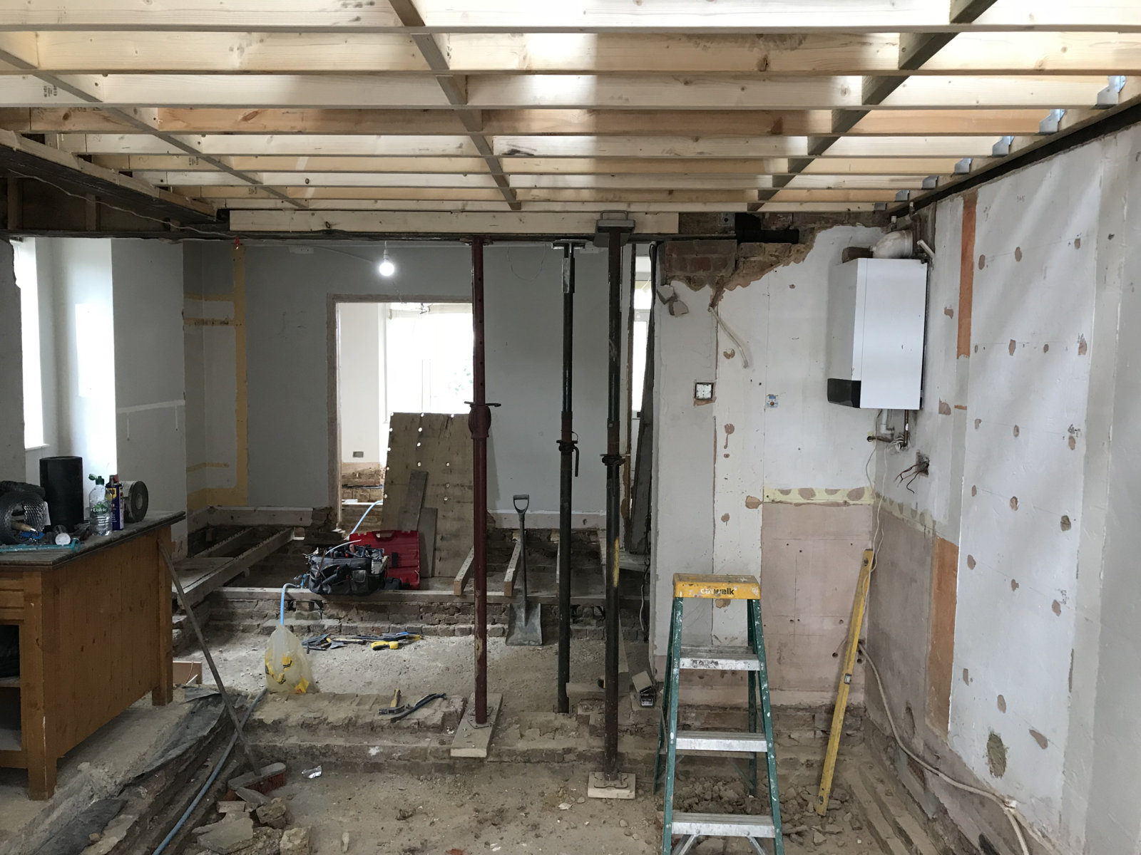

Here are a couple photos of the kitchen before the timber floor was installed.

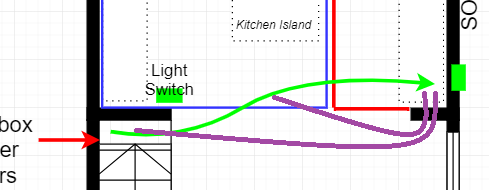

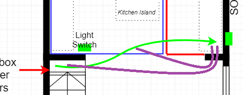

Would this work instead?:
Drill diagonally through the wall from under the units to under the floor in the area not bounded by blue or red rather than in the red area floor.
Sorry it's very far out of scale so probably looks a lot worse than it really is.
or possibly stop short of the support
View attachment 149575Sorry it's very far out of scale so probably looks a lot worse than it really is.
Or possibly stop short of the supporting wall
Hi Sunray. Thank you for your diagrams.
I did think of doing it as you suggested (through the side wall) but I was concerned about drilling multiple holes and weakening the wall which is not very wide and has a large RSJ sitting on it which holds the back of the house up. I could drill one hole and fit them all in but to reduce any grouping/heat issues as mentioned previously, I'd want to split up the cables.
