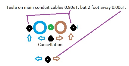

The current leakage is not causing me harm, not like before, but their is higher teslas around it, and i suspect its got mixed transients running on it. Only a scopemeter would show for sure.
Let me check...
Main earth bond to breaker box =0.00A
0.35A TN-S earth to PME,
L=1.95A N=1.95A
Tesla on main conduit cables 0.80uT, but 2 foot away 0.00uT.
Massive improvement over before.... it very noticeable.
I would say we are down against the average for the house.

Are you placing the sense head of the Tesla Meter in exactly the same positions as before or are you now placing it where it gives the readings best suited to "prove" the result you are seeking to find has been found. The black diamonds are the sense head positions, the arrows are the direction of magnetic field from the Live ( brown ) and Neutral ( blue ).. When they are equal and opposite the sense head will read zero.
