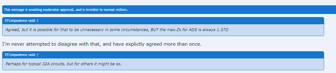

Agreed, but it is possible for that to be unnecessary in some circumstances, BUT the max.Zs for ADS is always 1.37Ω

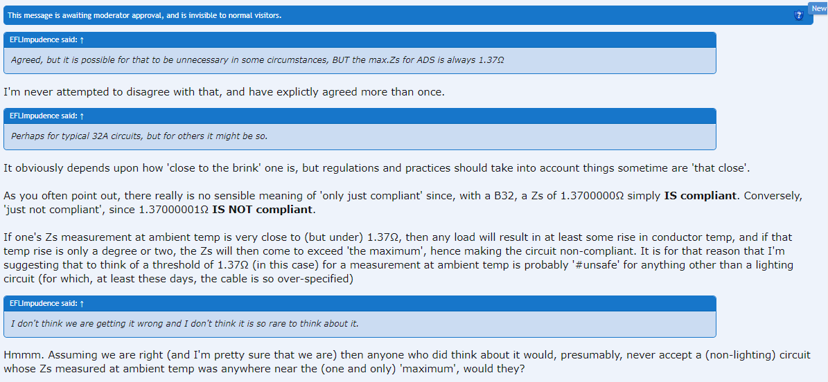

I'm never attempted to disagree with that, and have explictly agreed more than once.
Perhaps for typical 32A circuits, but for others it might be so.

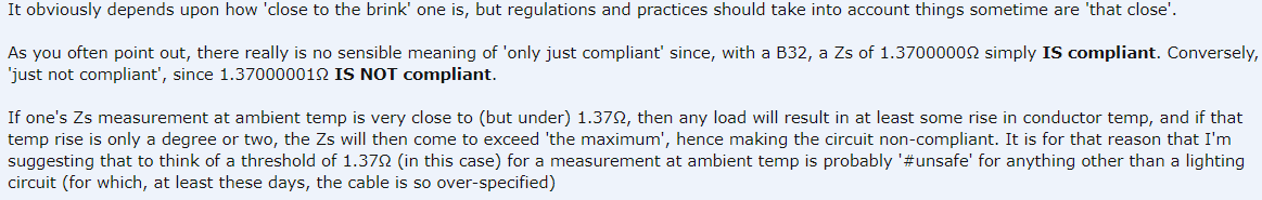

It obviously depends upon how 'close to the brink' one is, but regulations and practices should take into account things sometime are 'that close'.
As you often point out, there really is no sensible meaning of 'only just compliant' since, with a B32, a Zs of 1.3700000Ω simply IS compliant. Conversely, 'just not compliant', since 1.37000001Ω IS NOT compliant.
If one's Zs measurement at ambient temp is very close to (but under) 1.37Ω, then any load will result in at least some rise in conductor temp, and if that temp rise is only a degree or two, the Zs will then come to exceed 'the maximum', hence making the circuit non-compliant. It is for that reason that I'm suggesting that to think of a threshold of 1.37Ω (in this case) for a measurement at ambient temp is probably '#unsafe' for anything other than a lighting circuit (for which, at least these days, the cable is so over-specified)
I don't think we are getting it wrong and I don't think it is so rare to think about it.

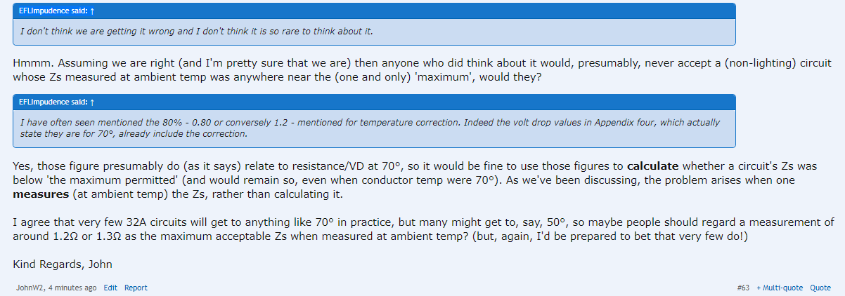

Hmmm. Assuming we are right (and I'm pretty sure that we are) then anyone who did think about it would, presumably, never accept a (non-lighting) circuit whose Zs measured at ambient temp was anywhere near the (one and only) 'maximum', would they?
I have often seen mentioned the 80% - 0.80 or conversely 1.2 - mentioned for temperature correction. Indeed the volt drop values in Appendix four, which actually state they are for 70°, already include the correction.
Yes, those figure presumably do (as it says) relate to resistance/VD at 70°, so it would be fine to use those figures to calculate whether a circuit's Zs was below 'the maximum permitted' (and would remain so, even when conductor temp were 70°). As we've been discussing, the problem arises when one measures (at ambient temp) the Zs, rather than calculating it.
I agree that very few 32A circuits will get to anything like 70° in practice, but many might get to, say, 50°, so maybe people should regard a measurement of around 1.2Ω or 1.3Ω as the maximum acceptable Zs when measured at ambient temp? (but, again, I'd be prepared to bet that very few do!)

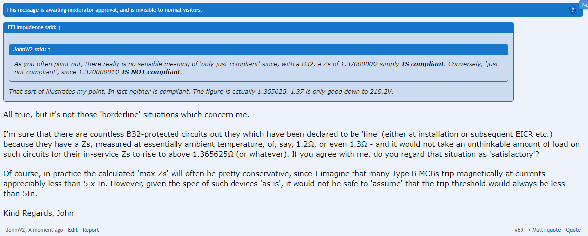

In fact neither is compliant. The figure is actually 1.365625.
1.37 is only good down to 219.2V.
That sort of illustrates my point. In fact neither is compliant. The figure is actually 1.365625. 1.37 is only good down to 219.2V.
All true, but it's not those 'borderline' situations which concern me.
I'm sure that there are countless B32-protected circuits out they which have been declared to be 'fine' (either at installation or subsequent EICR etc.) because they have a Zs, measured at essentially ambient temperature, of, say, 1.2Ω, or even 1.3Ω - and it would not take an unthinkable amount of load on such circuits for their in-service Zs to rise to above 1.365625Ω (or whatever). If you agree with me, do you regard that situation as 'satisfactory'?
Of course, in practice the calculated 'max Zs' will often be pretty conservative, since I imagine that many Type B MCBs trip magnetically at currents appreciably less than 5 x In. However, given the spec of such devices 'as is', it would not be safe to 'assume' that the trip threshold would always be less than 5In.
