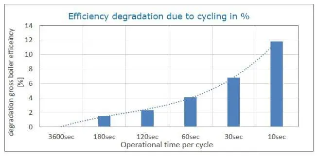

Below is some idea of the efficiency degradation vs cycling times

With both pumps set at 2 - over a 20 minute period after boiler had been on for 3 hours - it fired up for 6 minutes out of those 20 and was off for 14 minutes. There was 6 on and 6 off cycles and pump at boiler showed 40 - 44 watts!
If run time is 30% ie 20 minutes per hour does that compare to boiler that doesn't short cycle? Perhaps manifold speed down to 1 for another monitoring session in the garage!!
Boiler demand, 41*30%, 12.3kw, boiler circ flow 13.0LPM.
Firing time average of 60 secs, much of a much, this really won't change much, its the off time that will change with ufh chaning demand, if the ufh demand increases then the off time decreases. You should carry out some tests on CH only and HW only.
In view of the fact that there is 26/46kw stamped on your boiler you might ask Grant what is the actual lowest boiler output achievable, otherwise you just have to live with the 36kw when you change the nozzle.
