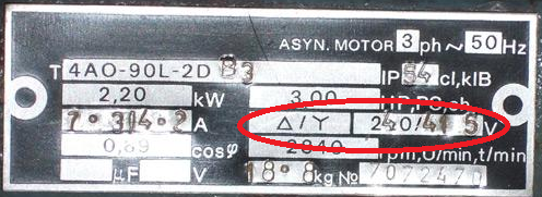

Here's a pic of the original motor wiring, motor plate star and delta wiring diagrams stuck to the underside of the junction box cover.
View media item 55805
Both the original and replacement motors are identical, as are the motor plates, it's only the connections that are different.
I was probably being a bit over cautious and should have just copied the connections on the original motor, but I'd be kicking myself for not checking had there been another bang!
Thanks to everyone for your help, really appreciate it
If you are certain about the above and it s going to be connected to the exact same supply then you need to reconfigure the new motor terminals to match the old
you need to go by the rating plate as already pointed out earlier on the first page and here by Lectrician
This is the important bit.
Delta 240v, star 415v.
For direct three phase connection (no inverter), you want star, so all links in a line along the top link W2 U2 V2.
if it says delta 230 star 400 then reconfigure the links
if it says delta 400v star 680v which I doubt then leave it as it is
