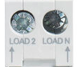

Unidirectional devices have an indicator to show the direction from supply to load, such as an arrow.
I'm getting very confused. Are you perhaps saying that all the RCDs which we 'know, love and use' are, in fact bi-directional, and that it is unilateral ones, if they exist, that are rare (and, as bernard has suggested, would probably be quite complex to produce) ?
Is it not because the RCDs "which we know, love and use" do not have any arrow or in/out markings that we quite often get asked whether it matters which way around they are connected - and that we normally say that it does not matter (give or take the caveat above)? Looking at the ones I have here that I can inspect, I see no 'directionality' indication on any of them.
The unidirectional device has the word 'out'. There are no markings on a bidirectional device.

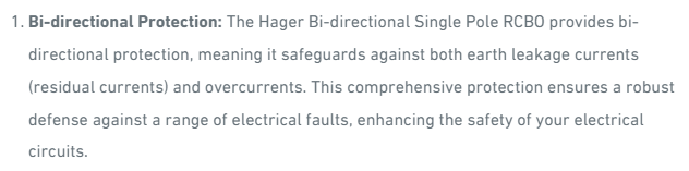

I looked at @flameport example and
is shown on the bidirectional. It is all well and good buying new, but when doing an EICR how does one know if the units fitted are OK.
I can see the problem however it also says MCB's and I had never considered a MCB could have a problem.
I looked at @flameport example and View attachment 342535is shown on the bidirectional. It is all well and good buying new, but when doing an EICR how does one know if the units fitted are OK.

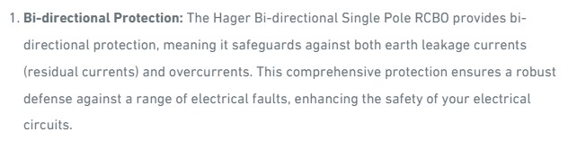

From the first of Flameport's links.
So - either another totally inappropriate name for an electrical item or possible an inaccurate translation from the original.
well its got me flummoxed too.
just a thought - I wonder if someone on this forum could ask the esteemed JW to do one of his excellent youtube articles for us mere mortals ;)
Reads as a normal RCBO to me "earth leakage and overcurrent"
... so, are they suggesting that "bi-directional RCD" means "RCBO" -, 'because' it provides over-current as well as residual current protection ? :)
This is getting a bit ridiculous :) I still have not got clue as to how a 'bi-directional RCD' would/does differe froim the RCDs which "we know, love and use", and I certainly struggle to think of why anyone would want a 'unidirectional' one (if such exist).
well its got me flummoxed too. ... just a thought - I wonder if someone on this forum could ask the esteemed JW to do one of his excellent youtube articles for us mere mortals ;)
That would be great, if he could do it - but that would require that he understands what a "bi-directional RCD' actually is (assuming it's different from the RCDs we know) - which may or may not be the case :)
is shown on the bidirectional literature. Then read @scousespark link which says
Wiring Matters March 2024 Bidirectional protective devices said:
A protective device that does not have markings to indicate line and load terminals is a bidirectional device
So it seems we are back to square one, we know what the problem is when connecting to power supplies through a unidirectional in that parts can remain energised after the device has tripped, however I still have no idea how to look at a device already installed and see if it is bi or unidirectional.
