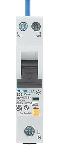

Bi and Omni directional RCD's how can one tell what has been fitted.

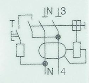

The difference is what is powered when the device trips.
When the RCD detection circuit trips - as opposed to the thermo-magnetic-mechanical arrangement for the MCB part - it will power a solenoid to trip the contacts. The solenoid and associated supply/control only needs to be rated for intermittent operation - and to get a good powerful operation it may well be designed for high current but only for a short time.
So what's the easiest way to cut power to the solenoid after the device trips ? Power it from the output - then when the contacts open, solenoid power goes off.
If you swap supply & load then the trip solenoid remains powered even after the contacts have opened.

However back to start, one is doing an EICR and one sees a MCB, RCD, RCBO, Isolator which has load marked on one side, if the load is marked on a side which could still be powered when the device is switched off, what is the code?
Be it a RCD/RCBO which is type AC or one where load in marked, what should the codes be. It seems the old idea of "Installations designed after" and "Existing installations that have been installed in accordance with earlier editions of the Regulations may not comply with this edition in every respect. This does not necessarily mean that they are unsafe for continued use or require upgrading." is no longer true.
I have not got a copy of the 18th maybe some can confirm or say if that clause is still in the book.

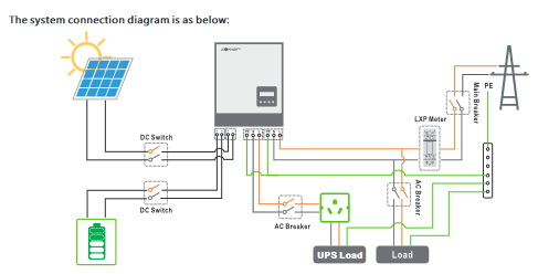

Having watched more you tube videos it does seem any reference to "LOAD" indicates mono direction. However it is also a question of where we actually have true bi-directional flow which can mean there is voltage both sides of the device.
Looking at the example with my own house the AC breaker to the UPS load is one direction only, the DC switch to battery is duel direction, but a special anyway as DC the DC switch to panels is one direction, the AC breaker to load is one direction, and although the main breaker is duel direction the anti islanding software will stop there being voltage on more than one side.
As to RCD the picture printed on the device
seems to show once tripped the test function is disabled.

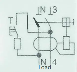

So it seems limited to RCBO's where they have a direction 1715544413799.pngso it seems unlikely there will be a problem in most cases with bi direction or maybe better to say where operation of the device will not make the output dead.

What I can not understand is why it matters which direction the power flows, I can see it making a difference if on opening both sides stay live, but if the inverter has anti islanding software then when the grid is lost, the inverter will stop producing.
So if the RCD is like this
and load goes to the inverter with N and 3 to grid, with a grid failure N and 4 would also loose voltage as the inverter will shut down. So what's the problem?
