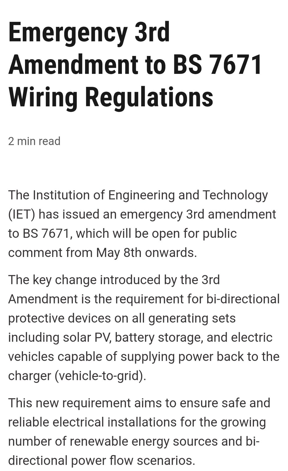

It is obviously desirable that, when current may flow 'either way' (as in solar installations etc.) that RCDs are capable of detecting and dealing with residual currents in both directions.
The authors of the 'Emergency Amendment' obviously believe that there are RCDs (maybe just RCBOs) out there which cannot cope with residual currents in both directions - but, as I and others have said, I can't see why such devices should exist - even thoough there is perhaps something wrong with my thinking!

People seem to be talking about current direction flow, which is clearly meaningless in this context. It is the direction of power flow that is being addressed by the amendment.
It would seem that where an RCD is designed as uni-directional, on tripping, if the device is connected back to front there will be some circuitry and or solenoid that should be disconnected by the operation of the device, but that remains connected, and fries.
