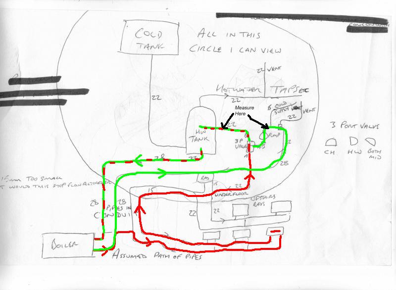

Thinking logically, to prove if the CH return is piped into the flow (as per 4expaw's earlier post) or totally blocked somewhere, you could:
1) Obtain a pair of clip-on pipe thermometers (or a IR thermometer), leave the radiators to cool and make sure all radiator valves are fully open.
2) Manually set the 3PV to HW only, turn on the boiler and measure the temperature of the HW tank flow pipe and the pipe entering the pump. Make a note of the difference between the two (they should be almost identical)
3) After a few minutes when the above temp has stabilised, manually turn the 3PV to CH&HW whilst you are still measuring the pipe temperatures.
If the difference between the pump and HW flow pipe temperature increases when you turn the 3PV to CH&HW, then it's highly likely the CH return is piped incorrectly into the boiler flow or blocked somewhere along the route. (ie. The temperature would lower if/when the cold(er) water from the CH return flows back through port A & diluting with the flow lowering the overall temp being measured at the tank flow pipe.)
To make it clearer, here's what maybe happening and assumes the 3PV is in the CH&HW position.
The RED route is how the radiators could be heating (Ive just included one for ease) and the GREEN route how the HW is being heated.
P.s. The thermometer(s) will cost around £10 and can be used afterwards to balance all your radiators when this issue is fixed!
Thinking logically the htg return is show connected to the boiler return, just the boiler is upside down, I would imagine it's indicative as the OP doesn't know.
In any case all the radiators work, now can there be a blockage.
What is blocking the circulation in the htg mode.
Why doesn't the boiler stat turn off in the HTG only mode.
This is a gravity boiler and would happily cut in and out on the stat all day long whether there was circulation or not.

Now my new line of thought says, that the 3 way diverter valve could have been installed incorrectly, where it has an in coming hot water port directly from the boiler via a pump, and two outgoing ports, one to CH circuit and the other to Hot water tank, if you think about it, if someone who carried out this installation years ago did not quite know and managed to connect pipes incorrectly, whereby the in coming hot water feed was actually connected to one of the out going porrts! and now you can imagine what is going to happen.......exactly! you get it, it would function exactly as the symptoms you have described, i.e. in both CH+HW it would function OK, the boiler won't cut off through overheat, because the circulation is in both direction, and if you only had your HW on, even then the system is fine as the flow is occuring between the hot water feed from the boiler and the HW cylinder
But now if you turned the switch to CH mode only, the flow from the boiler cannot flow out to any of the circuits, neither to CH nor to HW cylinder and the it takes around 20 to 30 seconds for the water to overheat and cut off the boiler.
I can safely assume someone has connected the 3 port valve incorrectly, now that you have determined your flow is fine as you have managed to get all your rads red hot! Time to trace exactly the hot water flow pipe from the boiler to this diverter valve and make sure it is plumbed into the in coming port, usually in the middle, as the middle part of a T

i will buy a couple of these temp gauges tommorrow presumably from a plumbers merchant and will run the test for temp and check which pipes get hot 1st that connect to the HW tank.
4expaws i have only just got round to looking at your post, one of my pictures shows the pipework under the floor, this is about 3 feet from the top of the conduit and there are no tees into the 28mm pipes above the conduit from under the floor, unfortunatly i have a built in wardrobe above so i cant see down the boxing, i will cut out the conduit at the side of the boiler which i think i will have to do thursday now. the ground floor is raised and if need be i will lift the carpet to see whats below the floor. you said that i had said the pipe below the 3pv was not hot, this may have been the case on one of the tests but it does get red hot when the valve opens to let water through. i will run through the rest of your suggestions when i have better access and have run the other tests above
The 3pv has been replaced and i have checked the hot water from the boiler is going to the middle of the 3pv, it was a while ago so i will recheck to make sure, i have replaced all the loft tanks with new ones so no debris, though this post maybe long i am greatful for the suggestions and understand that because of its length some of you wont want to read it all, the problem is we have not found what the cause of the boiler turning off is yet but i feel we are getting close with the barrage of recent tests, let me carry out the latest set and get a better view of some hidden pipes and lets take it from there.

To add to Mikes post, supposing he was closer than he thinks, and the pump and MV are actually on the return sucking out of the boiler.
Bills drawing actually shows something like that but it may have been indicative and not intentional.
Supposing the htg return was then connected to the bottom pipe and the flow from the MV, then the flow and return would be common either side of the pump/MV, and could in affect bypass the boiler.

edit: thanks for doing a drawing that would help op, and others to understand the problem better.
View media item 43343
Was thinking along a similar line earlier Mike, when looking at the OP drawing, which is clearly wrong, and wonder whether it was really connected that way.
As you can see from the drawing, if it was like this, there is no heating flow through the boiler.
