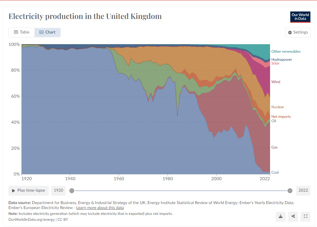

Quite! All I would add, is that very little of the UK's electricity is generated by oil in any case.
