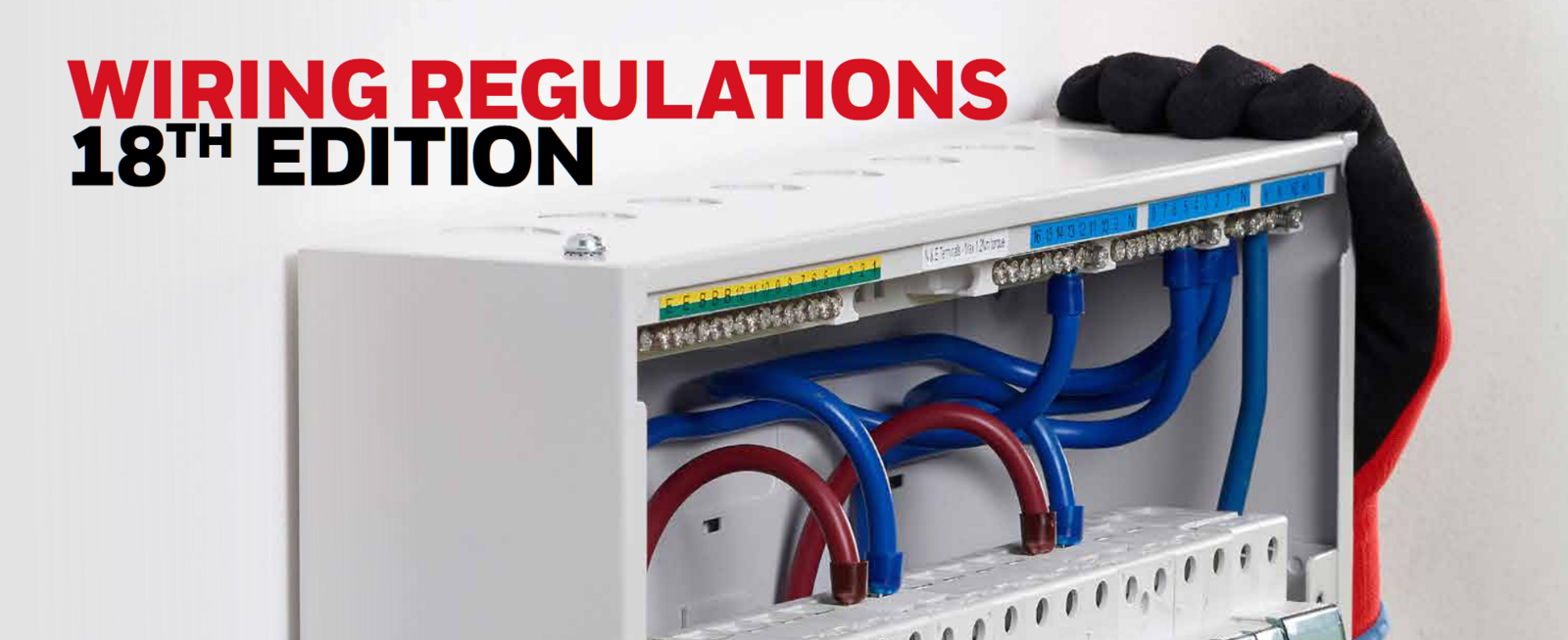

This extraordinary term "high integrity board/CU' (don't ask me :) ) seems to refer to a board which has two RCDs, but also has provision for a few (often only two) non-RCD circuits - hence three neutral bars.
As it happens, most of thee CUs in my house are these 'high integrity' ones!
Kind Regards, John
Yes of course you are correct there John , Dual RCDs and 2 or 3 plain switched fuseways.
If I understand the comments correctly then yes I have noted the 3 N terminals strips. N1 being the output of the DP Main Switch which in turn provide a N connection for both RCDs plus 2 or 3 extra terminals for use on MCB (or RCBOs if you wish) circuits. then the N2 being for RCD A/ circuits and N3 being for RCD B/ circuits.
So, speaking randomly, you might well have one chance in three of not creating the dreaded "Borrowed N Scenario"

My new one has three separate neutral bars. None RCD + main loops to the two RCD inputs, on the left. It wouldn't be too difficult to add one of the RCD neutral bars, directly to the none RCD bar, if one wanted to swap it over to RCBO's.
