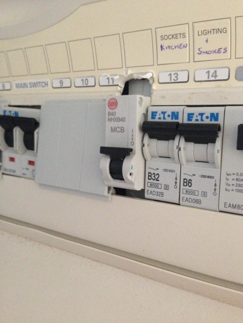

Mixed brand MCBs and EICR coding
How about the situation where a Protek mcb has been replaced with a ControlGear MCB? They're literally the exact same MCB but branded differently. Sure other cheap makes use the same mould too.
I don't think the fact that you 'know' that it is an identical product alters anything in regulatory terms. If the manufacturer of the CU does not specify that make as an 'approved' device for the CU. then unless you can somehow demonstrate compliance with BS EN 61493-3 (whatever it might say), then I think that the situation would, strictly speaking, be non-compliant with 530.3.4.
That's the 'strict regulatory' siuation. As for a common sense view ....... !!

It's a bit like GE making plug-in type breakers to specifically fit Wylex boards - yes I have seen them on sale in either Wickes/B&Q some years ago.
On din-rail mount system boards, a pick and mix selection breakers is a useful alarm bell, that DIY alterations may have been carried out an installation, and warrants further investigations.
You think someone must be pretty stupid in order to butcher a consumer unit and brute force another make of breaker onto its din-rail in order to get an extra circuit in.

There are cases like in the picture where some modification has been done. However even in the picture it is not plain to if the IP rating has been compromised or not. The real danger is not where we can see, but where without trying to remove the MCB you are really unaware if it is placing undue strain on the buzz bar and could that strain cause a false impression as to if there is a good connection on either the replacement or existing MCB's.
Main reason for me to fail a consumer unit is being able to remove the blanks without a tool. I see the Best Practice Guide does have some items I would not agree with. For example an immersion heater without a thermal cut-out is only a danger when the header tank is made from a thermal plastic, the header tanks designed for use with solid fuel heating will not fail if either the electric or solid fuel heat source was to cause the water to boil so it presents no danger.

To put a note bundled with the report saying the consumer unit has a mixture of MCB's which could adversely effect their operation and you would suggest this is rectified is OK, putting in the report is going OTT.
Yes, in 99% of situations that's exactly what I'd say.
In this case though it's a TP board installed within the last 3-4 years, still a current model and only 1 or 2 out of 20+ MCBs & RCBOs is correct. There are at least 3 different makes in there, could be 4 or could be just 2 versions of one of the makes. I'm confident it was done like that from new, and as far as I'm concerned there's no excuse for that, be it compliant or not.

With the picture
full
my concern would be if the blank can be removed without a tool rather than the MCB.
With the picture
full
Definitely can, they're standard wylex snap on blanks, if I remember correctly. They're certainly not Eaton blanks, they're DIN rail mount.
