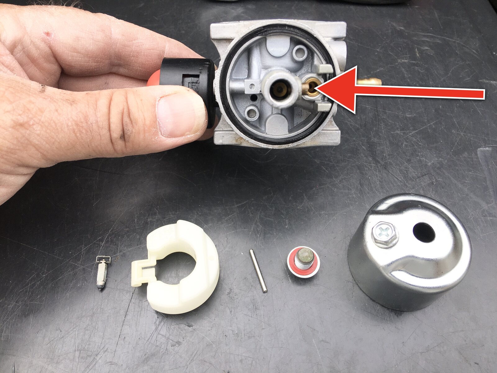

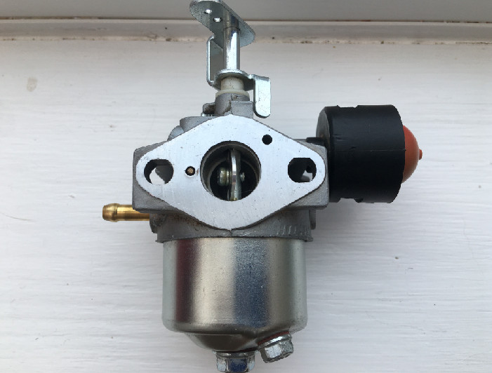

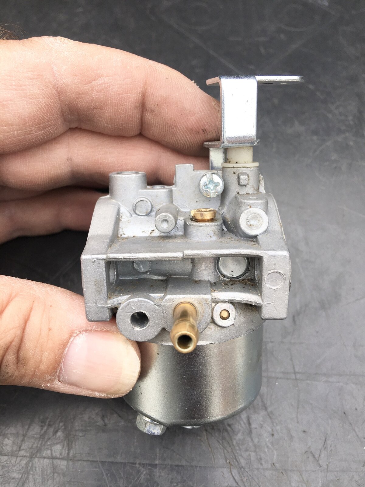

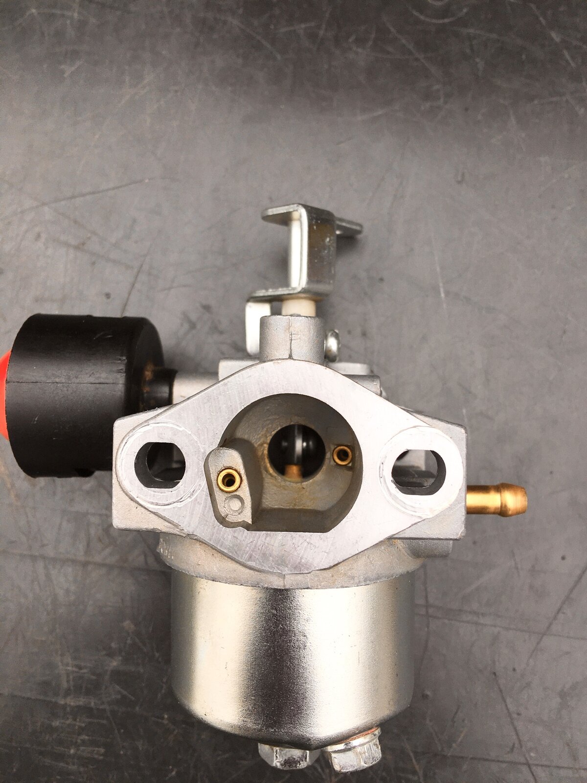

Just managed to look at it today.
Ive attaches the photos.

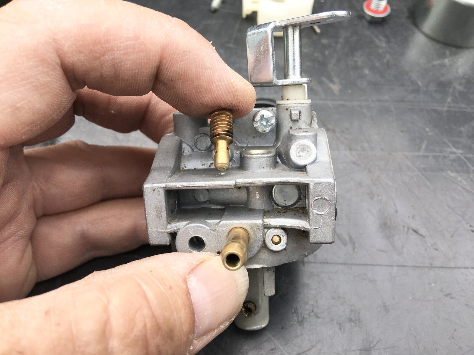

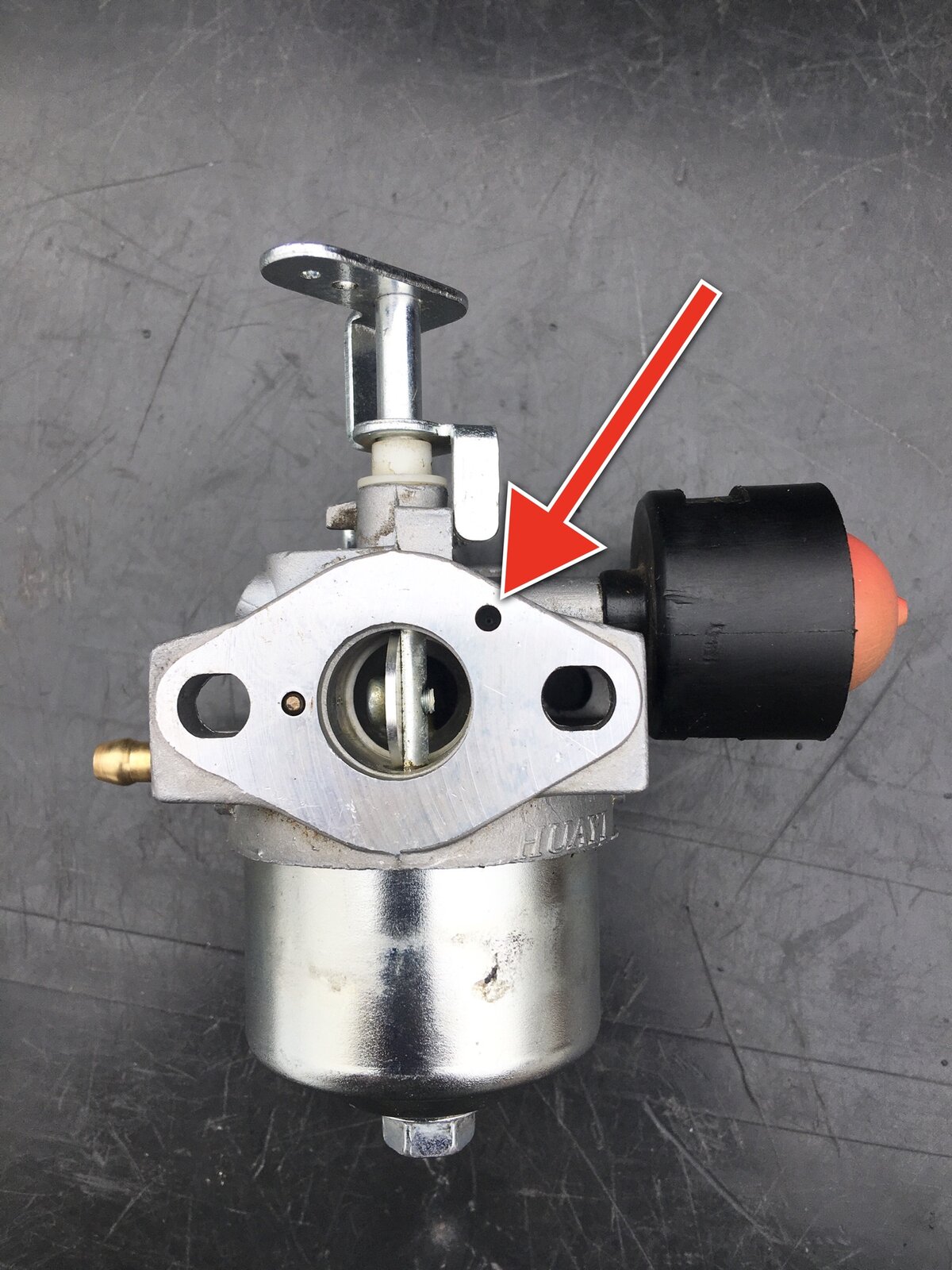

the small hole shown to the left of the red primer is where I would say excess fuel comes out. It then goes into the nylon spacer block then onto the floor. I assume an overflow system.
there is also an arrow that is horizontal pointing at a brass plug. This screws into the side of the vertical tube of which the needle jet is sat in. This brass plug does nothing as the hole it screws into is solid.
the bass jet etc that I’m holding has 2/3 hole at staggered positions so I am unable to look through them but I did leave it in fuel for an hour.
blowing with my mout or air line I feel no resistance as in any kind of blockage.

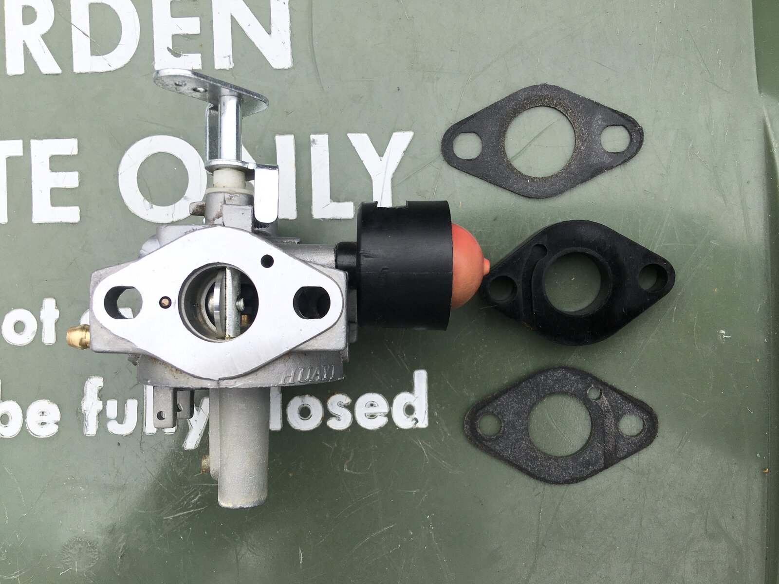

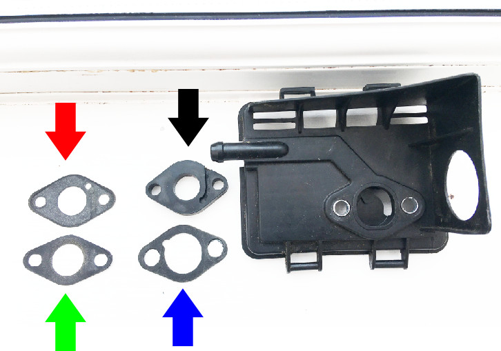

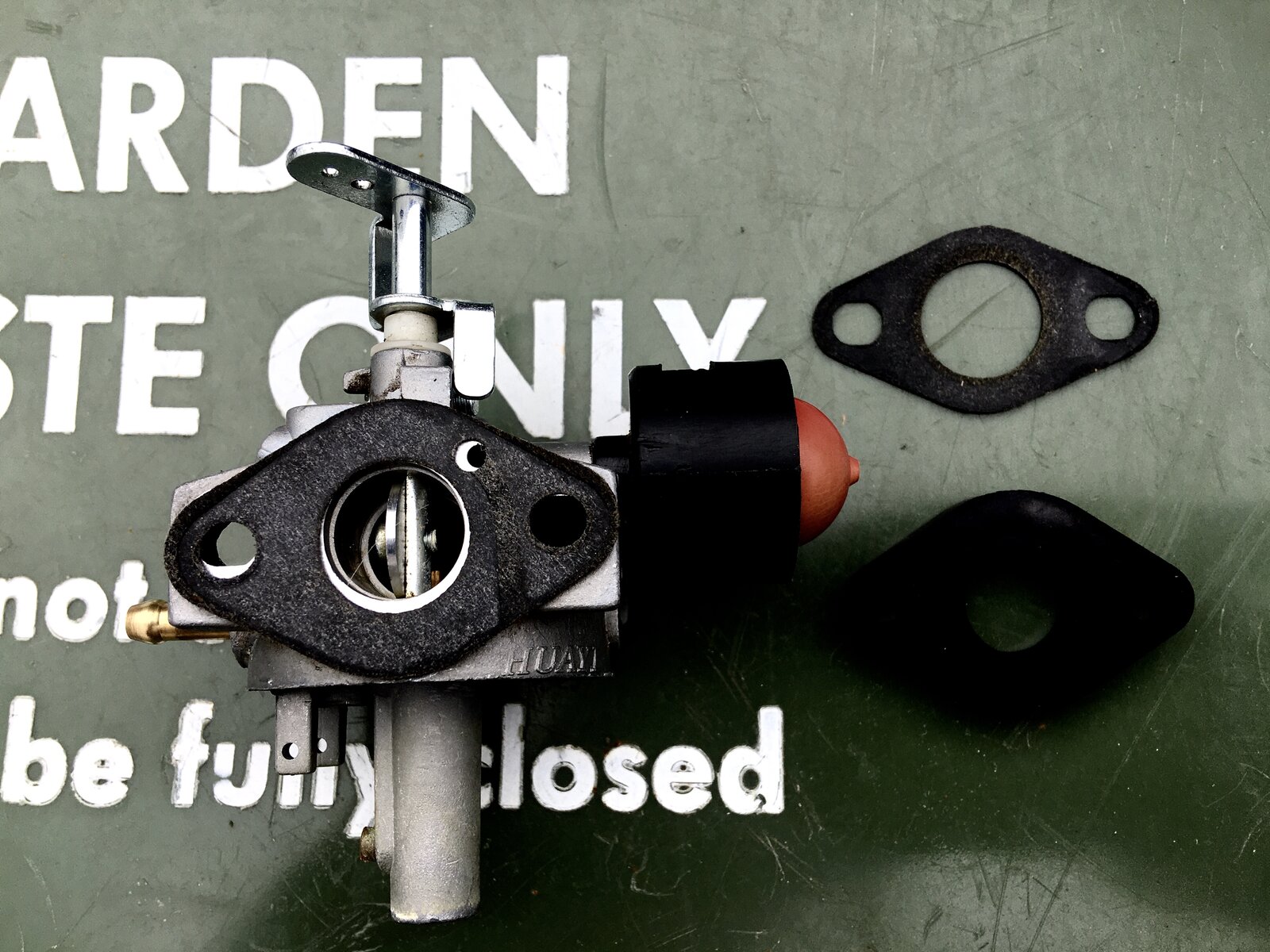

These are the gaskets.
Top fits to engine.
Then the block which has the hole then drain groove down down. Overflow ?
then hole in last gasket fits to block and on carb aligned with small hole.
Then a gasket between carb and air filter housing

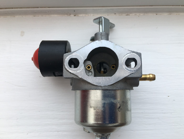

You mention choke.
I has put the parts back as i found them so lets assume the person before put then back in the wrong order thus creating a air gap of cutting off a hole etc.
Attached is fron & rear of carb also gaskets / block removed.
Where would you fit the block ?
Engine to carb or carb to air filter ?
Cant go by markings on gasket just in case these were impressioned by fitting them wrong
