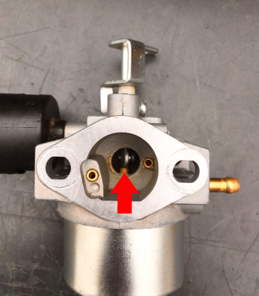

Picture 4 with the red arrow pointing to the main jet, on the side of the dip tube.
Picture 5, the slow running jet.
Everything looks fine, but I’ve never seen a carb the same as this but it is similar to some Tecumseh models.

When you press the primer bulb you need to see fuel coming out directly into the carb venturi.....at the very top of the pipe I called the dip tube, where the small brass main jet screws into the side.
So, with the carb off the engine but still held horizontal, pumping the primer should give you a drench of fuel through the main venturi of the carb.

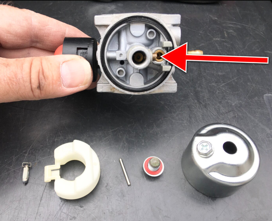

In the attached image whats the purpose of the brass item shown because ive unscrewed it expecting to have a hole in it but no.
Its not blocked as i can see metal and also feel metal when i try to clear it as if it was blocked.
The fuel cant enter that vertical part going up the middle as that is plugged with a 10mm bolt whent the float bowl is held in place.

Lets deal with this picture first.
The red arrow is pointing at the main jet, screwed into the dip tube. When the motor is running properly, all fuel passes through this.
The red arrow is covering the brass needle jet, but of course you are well aware of that.
Dead centre is the dip tube, part of the carb casting. Dead centre of that is the brass emulsion tube.....tapping the carb body may allow it to drop out, maybe not if its tight.
See the small hole at 8 o'clock? That's where the primer button pulse of air comes into the float chamber. So - when you press the primer bulb, fuel is pushed through the main jet , up the dip tube, through the emulsion tube and into the carb venturi.
Is the main jet clear?
John :)

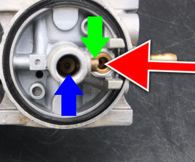

Wait.
Look at my attached photo to make sure were both talking about the sam item,ignor red arrow this time.
I am refering to the green arrow which screws into that tube at 90 degrees,there is no hole in this brass screw,
Im not talking about where the blue arrow is point as when i put the piece of wire through that part i then see it coming out of where you said the spray of fuel should be.
Neddle jet works fine & shuts off fuel when float is lifted.
The brass emulsion tube is clear in respect of me putting wire in one end & it comes out the other end BUT i havent taken it out so is there holes in the side of it ?
The hole at 8 o clock is also free & not blocked as my wire passes through it with ease.
So going by what you have said air comes from primer bulb & out the hole at 8 o clock.
It then passes through the item now arrowed with the green arrow.
Up that middle emulsion tube & out the brass piece you mentioned spray of fuel about.
Is that correct BECUASE wht you say is the main jet is solid with no hole ?
I poked / scrapped it for a while and nothing id moving at all.

Yes that part you call the main jet was left out when running in the video.
I can smell say meths / turps though.
I will remove the exhaust and burn it off.
I will also get a photo for you to look at what you call the main jet as this maybe where the issue is,be back in 15 minutes
The green arrow shows the main jet, screwed in. It should have a small hole in the centre.
The blue arrow points to the emulsion tube.
Great graphics!
John :)
My mistake,ive now managed to poke something blocking that main jet,must of been grit.
