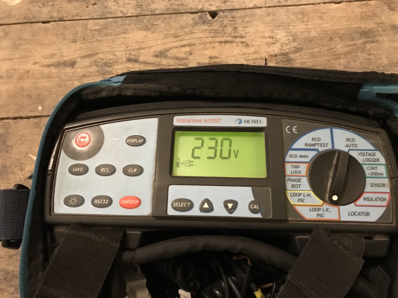

Following on from this statement, I’ve just had a look at my power meter and here you go:
Just thought I’d make sure it’s reading correctly with my calibrated MFT.
mine is currently 232v
never seen it so low
usually 240-244
