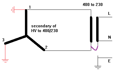

I was out on a call yesterday evening, customer complaining things failing.
voltage measured variously between 235v and 245v L-N. Sadly 410v N-E, 630v L-E and unstable 200v to 350v E- earthspike.
DNO came quickly and pulled tails and bonds. Generator provided today for about 10 properties.
At home now 235.7v, a few years back it would have been 250v to 255v as I'm very near the sub.
A colleague was back round there today as network engineers were reinstating supplies, It seems these properties are fed by a 400 to 230v transformer across 2 phases and a contact between primary wiring and secondary neutral/earth was being blamed. The figures don't add up for me but hey ho...

As you say, there seems to be an arithmetical problem there, since I don't really see how one can get 630V L-E out of what they are suggesting!

Well the numbers are there but I too struggle to see what fault(s) combined to give my test figures.
The best I've come up with is a 3ph transformer off the HV network with no earth on the star and an earth fault on the 'unused phase 3' or even on ph1 shown in red [I suppose it could have gone unoticed like it for a while if nothing else is connected between the transformers] and the broken earth & neutral/primary contact fault shown in purple:
But I'm grasping at straws and it doesn't explain the 200-350v found between the earth and spike.
