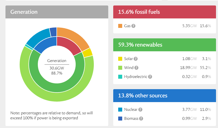

Agreed, but what did they have to make use of, when the wind didn't blow? If the wind always blew, and wind generation always generated at 100% of its maximum design capacity, then I would call it viable.

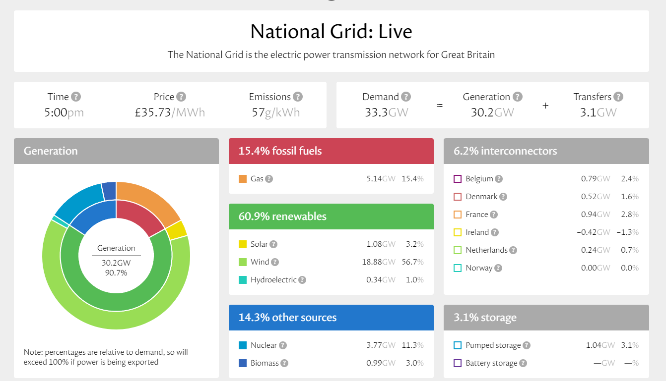

There are relatively few days each year when there is no wind, anywhere in the UK. Now that we have several interconnectors with other countries, you'd also be looking at days when there is no wind anywhere in the UK, or in Ireland, or in Norway, or in France, or in the Netherlands, or in Belgium, or in Denmark...
Those are live figures at the time of this post (17.11) 60% renewables, and 6% from abroad through the interconnectors. In fact we're currently exporting to Ireland.
