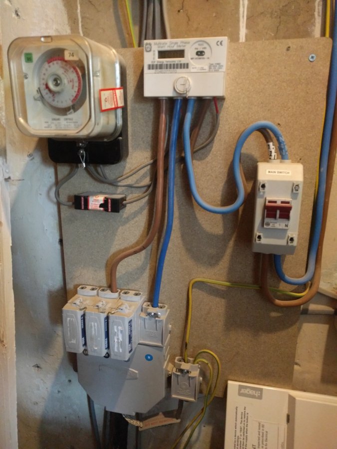

How would you categorise the situation (which I'm sure has been reported on this forum) of a premises where there's a 3-P cable coming in, there are 3 cutouts, but only one phase is used and there is only one single-phase meter and one single-phase CU? Is that an installation with a single-phase supply?

I don't think that one really presents any problems. Since only one of the phases which enters the building is connected to anything, I can't see that anyone would dream of describing what goes on electrically in the place (whether one calls it an 'installation' or whatever) as anything other than single-phase.

It would functionally. If only one phase is connected to anything (and, I presume, the other two don't even have fuses in the cutout), I would call it a single-phase supply, wouldn't you? The 'supply' is surely that which is made available to the consumer, regardless of what is inside the DNO's box?

Surely, if the three cut-outs are in your premises then the supply must be three phase.
That is what the DNO supplied.
That you don't use two of them does not alter that.
Surely, if the three cut-outs are in your premises then the supply must be three phase. That is what the DNO supplied. That you don't use two of them does not alter that.
I don't know. As I said, I would interpret 'supply' as what had been available for the consumer's use. If, as I suspect is likely, two of the phases don't have service fuses, I would not say that the DNO had 'supplied' those phases.
