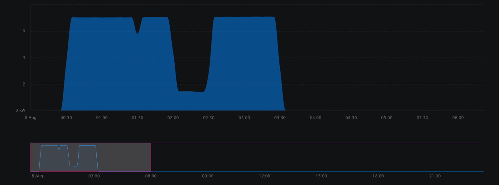

Smart charging and DSR currently works like this:
For a half hour period 02:30 to 03:00, EV charge rate was reduced from 7kW to about 1.5kW. This was just a test, but the concept is that if there was a period of excessive load on the electricity network and/or a loss of generation, EV charging can be temporarily reduced to avoid grid failure and blackouts.
The vehicle was still charged, it just took slightly longer. Made no difference to anything as it was still done by 03:30
This example was done by the manufacturer of the EVSE. A similar thing can be done by energy suppliers. This was for EV charging, but the same concept can be applied to other energy use such as hot water, space heating and home battery charging.
Demand side response is not new, it's been used for decades - plenty of large industrial energy users are paid to cut demand at certain times.
The difference is that now it's available to almost anyone if they want to participate.
