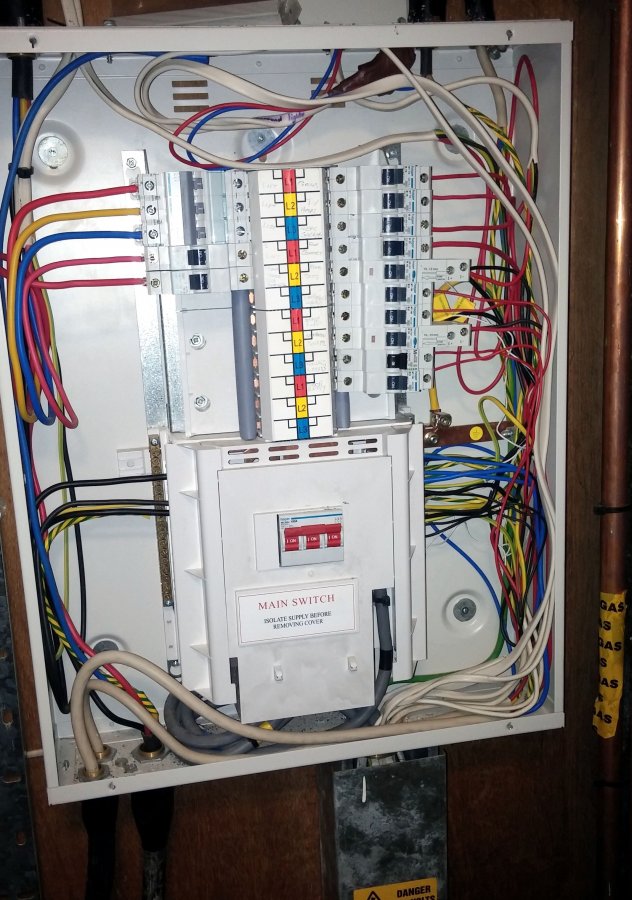

Mixed brand MCBs and EICR coding
Applying the highest standards of professional responsibility and duty of care, do you KNOW that they fit properly and do you KNOW that there CANNOT EVER BE ANY problems from mixing?

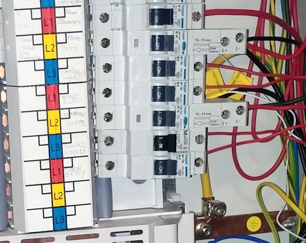

I don't see why most of these wrong MCBs are ever fitted - it's not as if MCBs of the majority of makes are difficult to obtain or cost vast amounts of money either.
If installing a new circuit or whatever, surely those installing it must have already seen the CU and noted the manufacturer of it?
Here's one which is less easy to see:
The offending item:

The question was "Would you code it on a commercial EICR and if so, what code and under what reg?" Reminding you once more that you would be (one would hope) applying the highest standards of professional responsibility and duty of care, and as you don't KNOW that they fit properly and you don't KNOW that there CANNOT EVER BE ANY problems from mixing, how can you ignore it, or just "make a note"?
You have to flag it as unsatisfactory, and needing further investigation.
