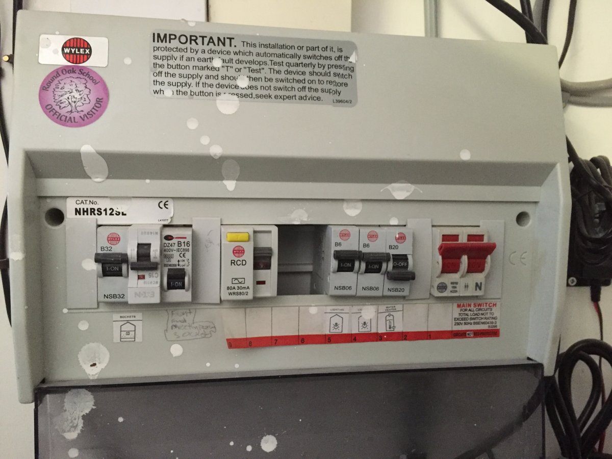

Well today I found the solution to the photo I posted earlier in the thread. The opposite way around though, Eaton into a Wylex board.
Gotta give the guy points for thinking outside of the box
That looks like a DIY bodge job to me! - I thought a key feature of the din-rail-mount-system fusebox, was to enable the easy identification of attempted DIY or other subsequent modifications to installations, after their original installation date!
In any case, history is not a guide to probability.
Hmmm. I can't actually think of any way in which one could obtain an estimate of the probability of these sort of events occurring other than on the basis of 'historic data'!
How does the DIN rail system tell you whether it was a DIYer or a rough spark that did it?
I would put my weeks wages on the fact that was not done by a DIY guy - ignoring what I know about the installation, as that's unfair
1. Wylex breakers are sold off the shelf at almost all DIY stores - Eaton are not
2. An Eaton C16 would be a wholesaler breaker, as would the one to its immediate right
3. Not sure a DIYer would've even thought to put it upside down
True, he could have got the breaker off eBay/from a wholesalers but if he was going to that much trouble I suspect they would have got the correct breaker
It's much more likely that it was the only 16a the guy had on his van at the time - maybe he intended to go back one day and change it, we'll never know
The trouble is that the lever will be Down for On, which is both dangerous and confusing for the layman, hence the DIY suggestion, and of course against the Type A board Din-Rail-Mount system standards, where UP is ON and Down is Off. This standard is internationally recognised, even in Mainland China (look at Alibaba and the circuit breaker pages!).
I realise this, as I've already mentioned. Still doesn't mean it was done by a DIYer
I proberly see at least 1 a week fitted backwards like that, even entire 3 phase boards with the correct make but all the breakers reversed, all places were done and maintained by so called tradesman
